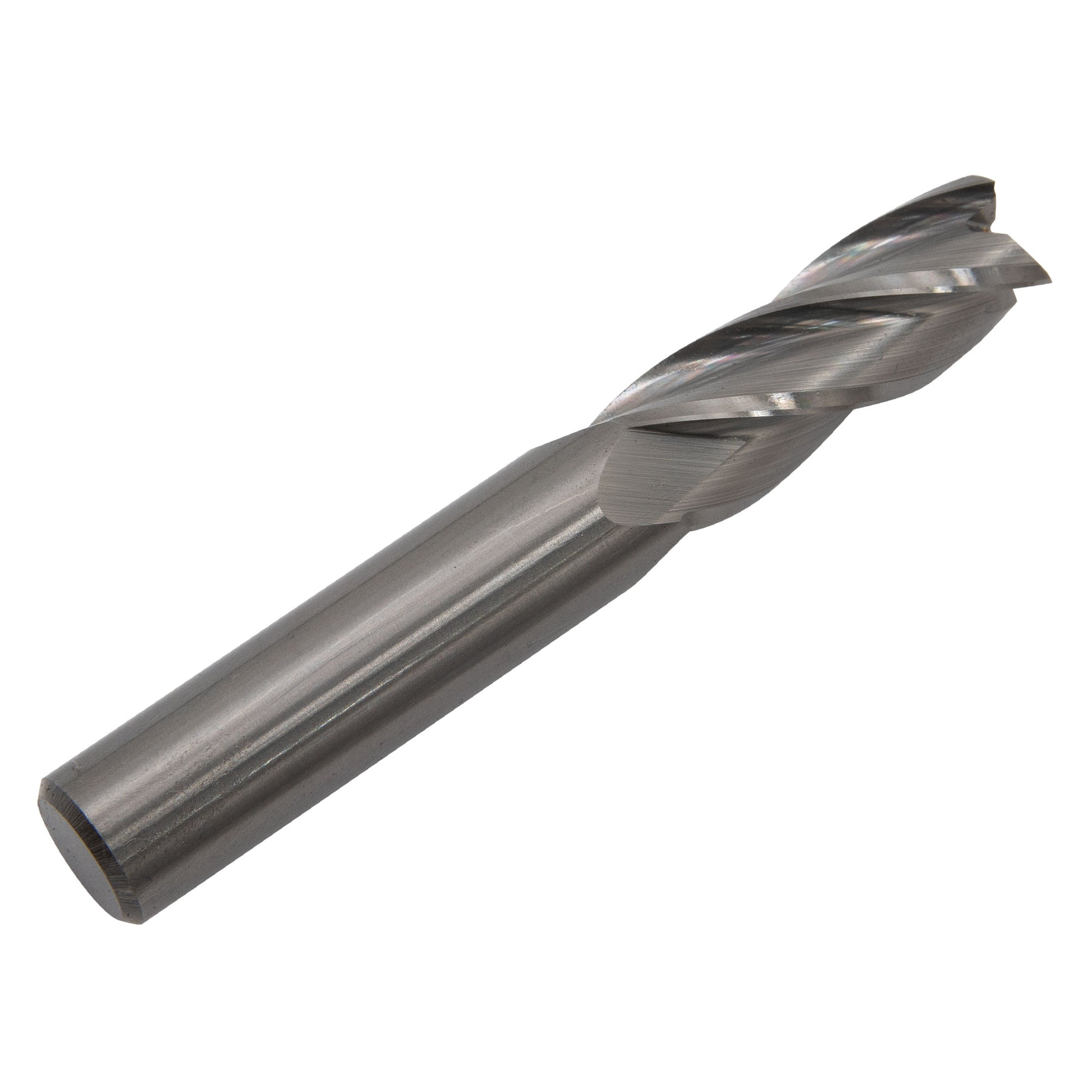

  • Single ended, 4 flute, center cut geometry
  • Designed for increased chip removal rate
  • Used for finishing operation
  • Ideal for milling, slotting, profiling and trace milling
  • Manufactured from premium submicron grain carbide
Single end 4 flute center cut end mill made from premium submicron grain carbide. Used for finishing operations. The 4 flute design allows for a high feed rate as less material is removed per flute. Ideal for milling, slotting, profiling and trace milling.
If greater swarf removal is desired, consider one of our 2 flute end mills.
Tolerances of these carbide end mills:
Cutting Diameter: +.000/-.002
Shank Diameter: -.0001/-.0004
Radius: +.001/-.001
Run-Out Tolerance: .0005 maximum shank to cutting diameter
Diameter: 1/8"
Flute Length (Loc): 1/2"
Overall Length: 1-1/2"
Cutting Diameter Tolerance: +.000 / -.002
Shank Diameter Tolerance: -.0001 / -.0004
Radius Tolerance: +.001 / -.001
