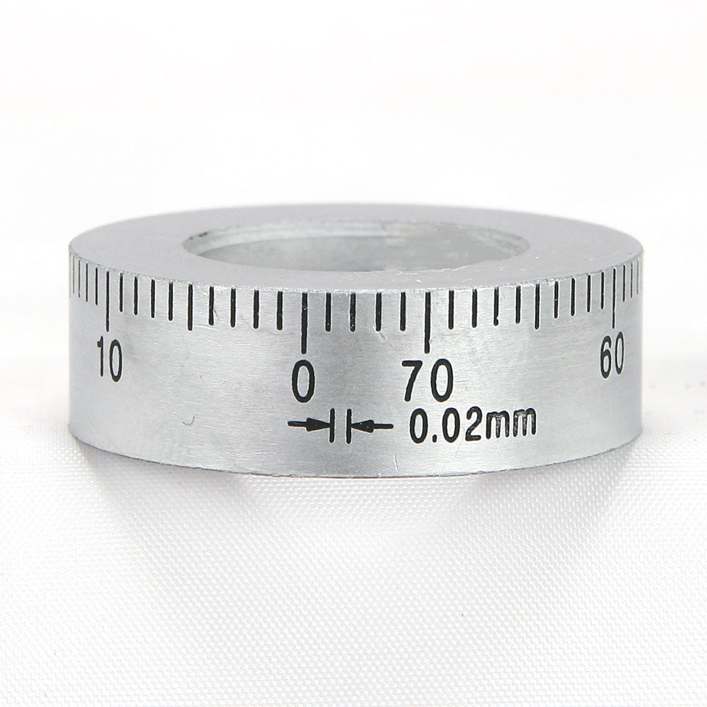

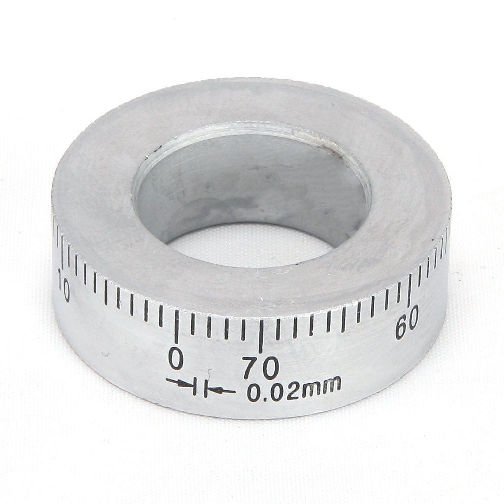

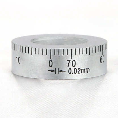

  • Graduated dial, 75 divisions
  • Used on X- and Y-axes of the metric feed kit for mini mills
  • OD: 35 mm
  • ID: 20 mm
  • Width: 11.3 mm
This graduated dial is used on both the X- and Y-axes of the metric feed kit for the mini mill.
This is not a standard part on any mini mill sold in the US.
The dial is 35 mm OD, 20 mm ID, and 11.3 mm wide.
