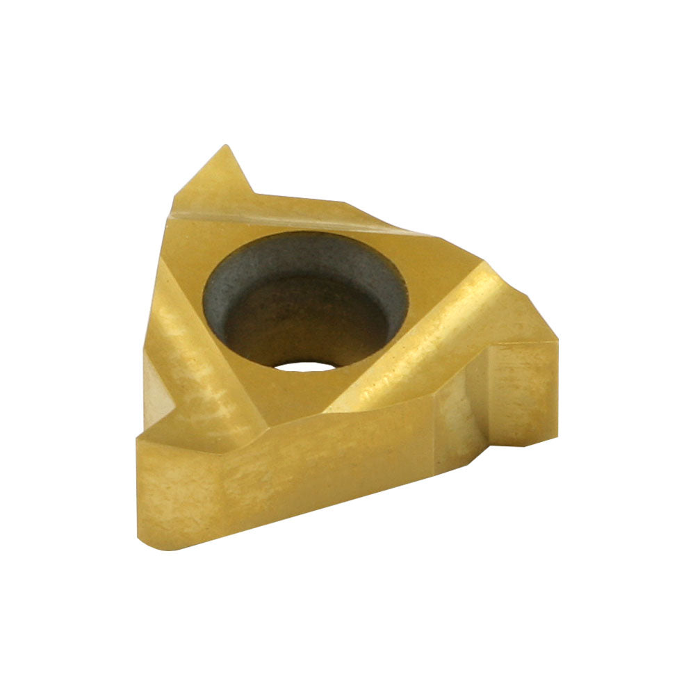

  • 60 degree threading insert
  • TiN coated Carbide
  • Pitch range (mm): 0.5-1.5
  • Pitch range (TPI): 16-48
  • 11mm I.C.
The 11ERA60 TiN Coated External Threading Carbide Insert is suitable for both CNC and manual lathes. It has a 60° V partial profile, allowing machinists to cut a wide variety of thread pitches without changing inserts.
The pitch range of this insert is 0.5 - 1.5mm and the TPI range is 16 - 48TPI. The inscribed circle (I.C.) is 1/4". The cutting edge is approx. 11mm with right-handed geometry.
The partial profile design (sometimes called non-cresting) only cuts the thread groove. Due to the small nose radius (0.003") a single insert can cut multiple thread pitches providing the profile angle is 60°.
The carbide substrate absorbs the cutting force and vibrations when threading steel, stainless steel and cast iron. The TiN (Titanium Nitrite) coating provides low friction and high surface hardness. Its heat and wear resistance extends the life of your cutting tool.
This insert is designed for light to medium roughing, finishing, and semi-finishing passes.
