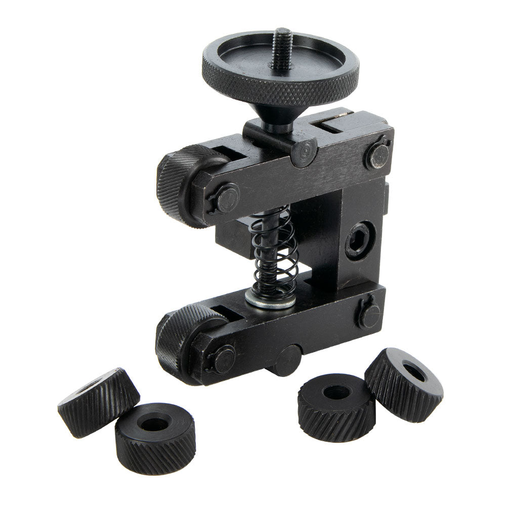

  • 0 to 2" (50 mm) diameter capacity
  • Fits standard 4-way and quick change tool posts
  • Includes three sets of knurls
This scissors knurling tool is made to our design, specifically for the mini lathe.
This knurler fits in the standard tool post of the mini lathe without any modification. This knurling tool also works with any of the quick change tool posts we sell.
The mounting bar is 3/8" (9.5 mm) tall so it replaces a 3/8" tool bit.
It comes with fine (33 lines per inch, 0.8 mm pitch), medium (21 lines per inch, 1.2 mm pitch), and coarse (14 lines per inch, 1.8 mm pitch) diamond knurls.
