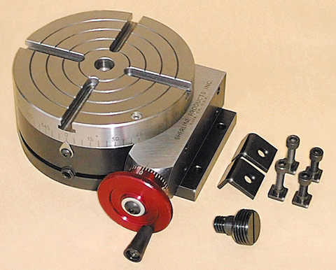

The rotary table is 2" high and 4" (100mm) in diameter. The main components are machined from solid steel bar stock. The table is engraved with a laser, giving sharp and precise lines every 5°, numbered every 15°. These lines are calibrated with the 72-tooth worm gear that is driven by the hand wheel. The hand wheel is divided into 50 parts, making each line on the hand wheel 1/10°. This allows a circle to be divided into 3600 increments without interpolation. Seventy-two revolutions of the hand wheel rotate the table one revolution.
The Sherline Rotary Table works with the Right Angle Attachment and the Right Angle Adjustable Tailstock.
