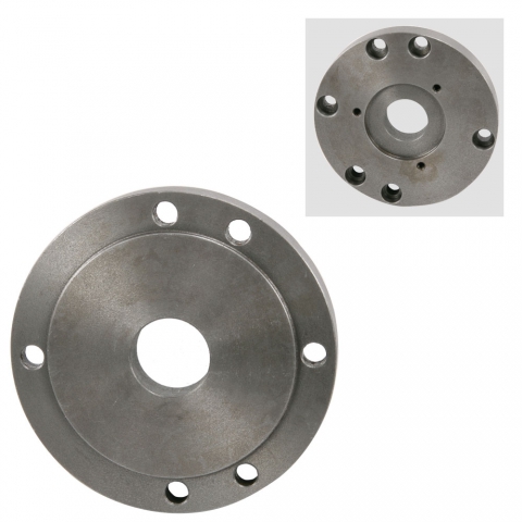

5" Lathe chuck adapter.
This adapter lets you mount a 5" lathe chuck on your mini lathe in place of a 3" (80 mm) chuck.
The adapter mounts to the 3-hole pattern on the spindle so it works on spindles with only three holes.
This adapter has a 95 mm diameter registration boss and is drilled for both 3- and 4-jaw chucks on a 108 mm bolt circle.
| Outside Diameter | Ø 4.9" (125 mm) |
| Overall Thickness | Ø 0.77" (19.5 mm) |
| Center Hole | Ø 1.2" (30 mm) |
| Spindle Side Registration Recess | Ø 2.2" (55 mm) |
| Spindle Side Bold Circle | Ø 2.6" (66 mm) |
| Chuck Side Registration Boss | Ø 3.7" (95 mm) |
| Chuck Side Bolt Circle | Ø 4.3" (108 mm) |
| Chuck Mounting Holes | 6 |
