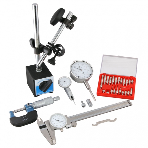

  • 1" Dial indicator, magnetic base and point set
  • 0-30-0 Dial test indicator
  • 0-1" micrometer
  • 6" Dial caliper
  • Plastic case
Part Number: 2518
Weight: 7.10 lb
$109.95 On Sale
Regularly $119.95
PayPal Credit
This set includes all the basic precision measuring tools.
The micrometer has a range of 0-1" and a resolution of 0.0001". An adjustment wrench is included.
The dial caliper has a range of 0-6" and a resolution of 0.001".
The dial test indicator has a range of 0.030" in either direction and a resolution of 0.0005". It includes 5/32" and 3/8" diameter posts, dovetails on the back and end, and a 0.080" diameter point.
The dial indicator has a range of 0-1" and a resolution of 0.001". Each revolution is 0.100", indicated by the revolution counter. There is a mounting lug on the back of the case.
The magnetic base has on on-off switch for the magnet and incorporates a fine adjustment feature.
The point set includes 22 of the most popular points. All have #4-48 threads for use in AGD 1, 2, 3, and 4 indicators.
