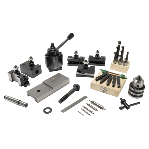

Bench Lathe Tooling Package, Basics + AXA QCTP (9x20 HiTorque)
  • AXA QCTP Set with post mount
  • 3/8" Indexable TCMT Inserts, P1 Cut-Off Blade
  • 1/2" Drill Chuck, 2MT Standard to 33JT Drill Chuck Arbor
  • 9-piece carbide Boring Bar Set - 1/2" shank
  • 5 Center Drills (sizes 1-5)
Part Number: 6718
Weight: 18.2 lb
$399.95 Value Price
Purchased individually $401.79
*** Current market conditions are causing us to make substitutions in tooling packages that may not be reflected in the above image. Please check contents tab before ordering.
DESIGNED TO UPGRADE HITORQUE BENCH LATHES WITH A 9" SWING TO AN AXA TOOLPOST. Current SC50 compound rest top must be swapped with the 6573 top that is included with this kit in order to mount the AXA post
This package contains all the tooling you need to be productive with your lathe on the first day you own it. It works with the LittleMachineShop.com HiTorque 9x20 bench lathes as well as other SC50 lathes.
Includes an AXA (Series 100) quick change tool post set (QCTP).
This set includes the tool post and the following tool holders:
2 - #1 Turning and Facing
1 - #2 Boring, Turning and Facing
1 - #4 Heavy Duty Boring will hold both 5/8 and 3/4 boring bars
1 - #7 Universal Parting Blade (for 1/2 inch cut-off blade - horizontal)
The quick change tool post is made from hardened steel. No tools are required to change tools. Additional tool holders are available.
The turning tool holders accept tools with 3/8" to 1/2" shank. The turning and boring tool holder accepts boring bars with up to 1/2" round shanks. The cut-off tool holder holds 1/2" tall parting blades.
The 1/2" capacity drill chuck is mounted on a standard 2 Morse taper shank. The rated capacity of the drill chuck is 1 mm (0.039") to 13 mm (0.512").
The set of 3/8" shank indexable turning tools includes 5 tools (TAR, TAL, TBR, TBL, TE), inserts, a wrench, and extra screws. It comes in a fitted case. The carbide inserts are TCMT21.51.
The carbide tipped 9-piece boring bar set includes three different length boring bars each for minimum bores of 5/16", 3/8", and 7/16". The bore depth ranges from 3/4" to 2-1/4". The heat treated, alloy steel shanks are held to 0.000 to -0.0005" from the nominal diameter.
The P1 parting blade is 5/64" x 1/2" x 4-1/2" and made from M2 HSS. These T-shape parting blades provide great side clearance.
This package includes 5 different sizes of combined drills and countersinks, commonly called center drills. The center drill set is high speed steel and includes sizes 1, 2, 3, 4, and 5. These are 60 degree center drills. These are the sizes that are most used by bench top machinists.
**NOTE** If your lathe came with a turret tool post and you are intending to upgrade to an AXA tool post you may need to upgrade/modify the compound and tool post stud. Please read all information and check compatibility for this product.
This kit comes with 1/2" boring bars which can be held in the #2 tool holder from the AXA set - Turning & Boring Tool Holder. The dedicated boring bar holder that comes in the AXA set holds 5/8" and 3/4" which we feel are too large for a lathe of this size.
P-type cut-off (or parting) blades are T-shaped (don't ask). Because the body of the tool is narrower than the cutting tip, friction is reduced making the difficult task of parting off somewhat easier.
Size P1 blades are 1/16" wide and are the most commonly-used size. P1N blades are 0.040" wide. These thinner blades are good for small work. P1X blades are 5/64" wide. Use these thicker blades for parting off larger diameters where you need additional stiffness.
It is easier to part off large diameters if you cut a groove that is wider than the cut-off blade. First, make a cut about 0.100" deep. Now back out and move over at least 0.010". Cut in again, widening the slot. Continue with this cut until you are 0.100" deeper than the first slot. Repeat this process, moving back and forth, until you are through.
Combined drills and countersinks, commonly called center drills, are used to produce a center hole on a workpiece for turning between centers. Center drills are also used to start drilled holes. Because they are very stiff they don't have a tendency to wander.
