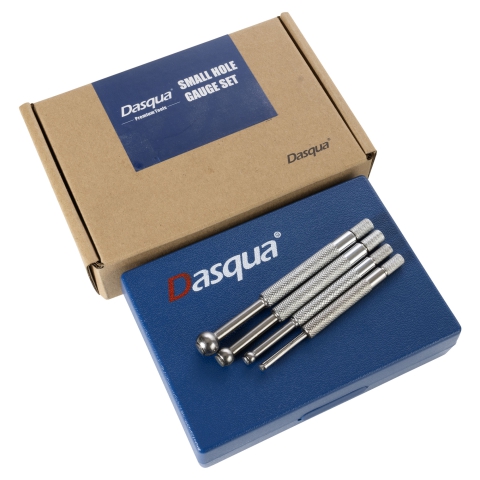

Small Hole Gage Set, 4-Piece, Dasqua

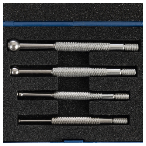

  • 4 small hole gages with 0.125" to 0.500" range

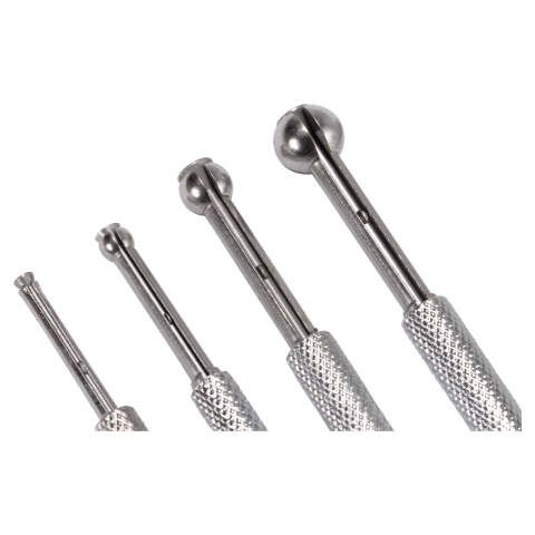

  • Full spherical ball for very accurate measurements
  • Hardened, satin-chrome plated measuring faces
Part Number: 3093
Weight: 0.35 lb
Price: $29.95
The Small Hole Gages are ideal for accurately measuring small holes, slots, grooves, and recesses. This makes it perfect for general work where more accurate measurement is required.
These gages have a precision ground radius on each gage that provides two-point contact for maximum accuracy and a hardened-ball measuring the surface with two-point contact.

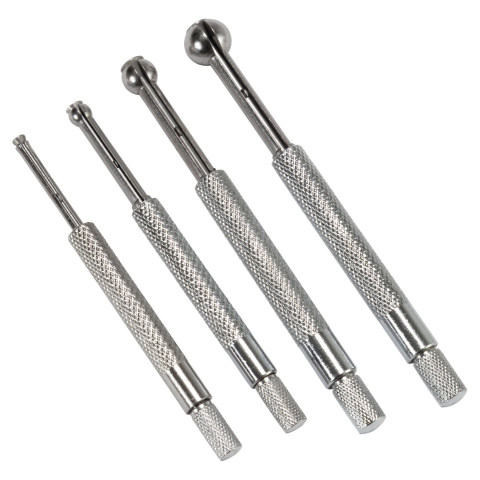

How to use a small hole gage set
  1. Insert the appropriate gage (smaller but closest to bore diameter) into the hole.
  2. Rotate the knurled base to expand the end until a slight pressure is felt when the gage is moved in the bore.
  3. Remove the gage and measure with a caliper or micrometer.
