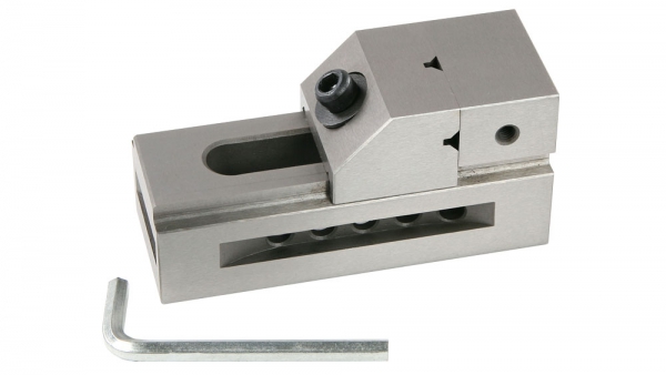

Vise, 1.5" Screwless
  • Jaw can be opened and closed without unbolting from work surface
  • 1.5" jaw width
  • Square and parallel .0002"
  • Overall length is 100 mm
Part Number: 3950
Weight: 1.90 lb
Price: $64.95
This high precision toolmakers screwless vise has a one-piece body. The body and jaws are hardened to Rc 58-62. All sides are flat, square, and parallel to 0.0002".
The jaws are 0.75" deep and open to 1.5".
The vise is 3.94" long x 1.5" wide.
Jaw Depth 0.75" (19.0 mm)
Maximum Jaw Opening 1.5" (38 mm)
Table to Bed 1.21" (30.7 mm)
Table to Clamping Slot 0.46" (11.7 mm)
Height 1.97" (50.0 mm)
Length 3.94" (100.1 mm)
Width 1.60" (40.6 mm)
Weight 1.9 lbs (0.9 kg)
