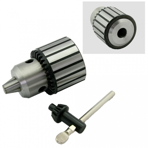

Drill Chuck, 5/8" Professional Grade
- Precision made with the highest TIR
- Designed for heavy duty jobs
- Key included
- Capacity: 1/16” - 5/8”
- Mounts to 33 Jacobs taper arbor
1/16" - 5/8" Capacity professional drill chuck. Designed for heavy jobs; all working parts are hardened and manufactured to the highest standards for durability and straight alignment.
This 5/8" drill chuck is comparable to a Jacobs 34-33 heavy-duty drill chuck, including the runout specification of 0.004" (0.10 mm) or less. Chuck key is included.
Chris' TipsUse a 3MT to 33JT drill chuck arbor with the mini mills having a 3 Morse taper spindle.
| Capacity | 0.06" - 0.63" (1.5 mm - 16.0 mm) |
| Maximum Runout | 0.004" (0.10 mm) |
| Mount | 33 Jacobs Taper |
