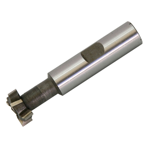

T-Slot Cutter, 3/8" T-slot, HSS
  • For 3/8" T-slots (measured at the top of the T-slot)
  • Cutting diameter 25/32", cutting width 21/64"
  • Neck diameter 13/32", shank diameter 3/4", bolt size 3/8"
  • Undercut length 3/4", OAL 3-1/4", 6 teeth
  • Positive radial rake, right and left-hand spiral
Part Number: 5195
Weight: 0.17 lb
Price: $24.95
T-slot cutting tools are designed to make T-slots in tables and beds.
Two milling cutters are required for milling T-slots, an end mill and a T-slot cutter. A 3/8" vertical slot is milled into the piece so that the neck and shank of the T-slot cutter can enter.
Our high speed steel 3/8" T-slot cutters have positive radial rake, right and left hand spiral with alternate side cutting teeth for maximum chip clearance.
T-Slot Width 0.375" (9.52 mm)
Cutting Diameter 0.656" (16.67 mm)
Cutter Width (Depth) 0.266" (6.75 mm)
Bolt Size 5/16"
Neck Diameter 0.328" (8.33 mm)
Shank Diameter 0.50" (12.7 mm)
Undercut Length 0.609" (15.48 mm)
Overall Length 2.6875" (68.263 mm)
