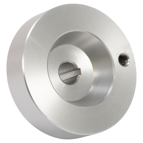

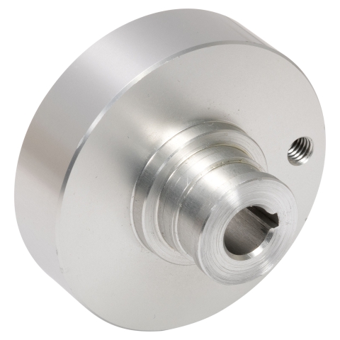

  • Bench lathe compound rest handwheel
  • Fits HiTorque 9x20 bench lathes without DRO
  • 60 mm outside diameter
  • Fits 10 mm shaft with a 4 mm key
  • Bore is 23 mm, handle threading is M6
Part Number: 6578
Weight: 0.25 lb
Price: $19.95
Compound rest handwheel for the HiTorque 9x20 bench lathes and SIEG SC50 bench lathes without DRO. The hand wheel is 60 mm in diameter. It mounts on a 10 mm shaft, with a 4 mm key. The length through the bore is 23 mm. There is an M6 threaded hole for a handle.
The handwheel is anodized aluminum.
