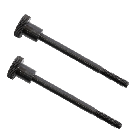

  • Threaded thumb screw for HiTorque and SIEG mini lathes
  • Designed to replace cap screws on change gear cover
  • Knurled end allows for quick access to gears without tools
  • Save time and effort in executing your lathe operations
  • This item is made specifically for LittleMachineShop.com
Part Number: 6658
Weight: 0.20 lb
Price: $7.95
Custom made for LittleMachineShop.com to fit HiTorque mini lathes and SIEG SC20, C3 and SC3 mini lathes. This product is sold as a pair of screws.
Replace socket head cap screws on the change gear cover with these screws to allow for quick, easy access to the gears. No need for Allen wrenches whenever you need to modify the gear combinations.

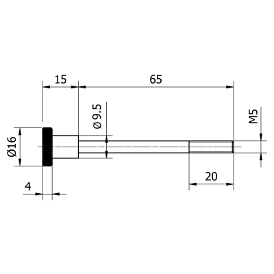

Overall length is 80mm.

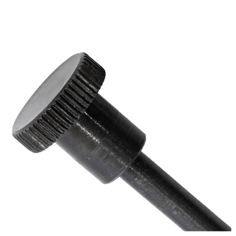

Knurled knob is 16mm in diameter and 4mm thick with a straight knurl.
Length from top of knob to bottom of thick shaft is 15mm.
The unthreaded shaft is 9.5mm diameter and 45mm in length. The threaded portion is 20mm in length and is 5mm threading.
Made of black steel.
Here is a drawing of the Knurled Thumb Screw
Technical Drawing of the Knurled Thumb Screw
knurled thumb screw
