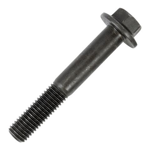

  • Makes AXA QCTP a bolt-on accessory for HiTorque 9x20 lathes
  • Threads through tool post into compound rest
  • Outside thread is 14mm x 2mm
  • Length: Shaft (90mm/34mm threaded), Bolt Head (12.88mm)
  • Hex head is 18mm
Part Number: 6721
Weight: 0.30 lb
Price: $5.95
Black-phosphate class 10.9 steel bolt which is run through the middle of the AXA tool post into the 14mm x 2mm threading of the compound rest.
The shaft length is 90mm with min. thread length of 34mm. The hex head height is 12.8mm with an 18mm hex head and a 30.5mm flange.
Material Class 10.9 Black-Phosphate Steel
Thread Direction Right
Thread Size M14
Thread Pitch 2 mm
Thread Fit Class 6g
Length 3.5" (90 mm)
Threading Partially
Min. Thread Length 1.3" (34 mm)
Head Width 0.7" (18 mm)
Head Height 0.5" (13 mm)
Flange Diameter 1.2" (30 mm)
Strength Grade/Class Class 10.9
Hardness Rc 32
Specifications Met ISO 898-1
