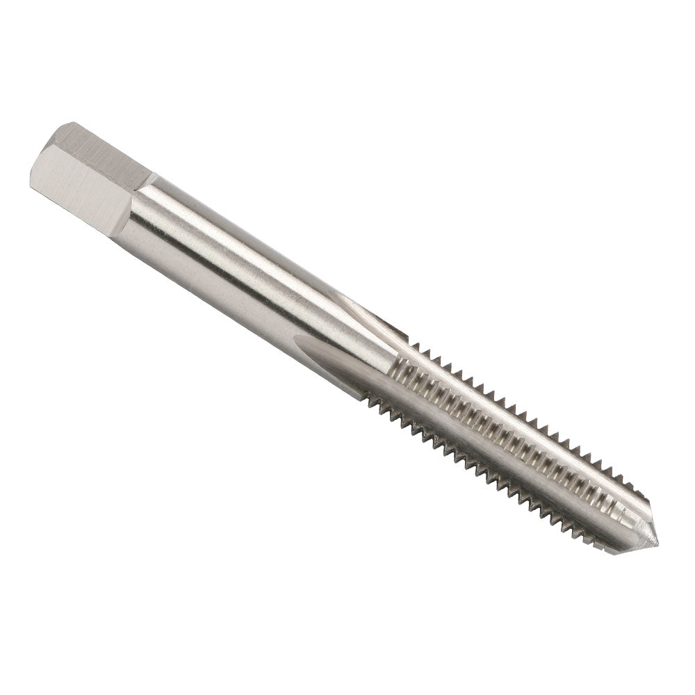

  • Metric Sizes M3, M4, M5, M6, M8, M10
  • High speed steel (HSS)
  • Plug style (3-5 chamfered threads)
  • Utilize in through or blind hole tapping
Hand taps are the most commonly used general purpose tap. They are recommended for tapping free machining steels, stainless steels, aluminum, zinc, and ductile materials.
Plug taps have 3-5 chamfered threads and are utilized in either through or blind hole tapping.
The High-Speed Steel (HSS) construction gives good wear-resistance.
Metric Sizes M3x0.5, M4x0.7, M5x0.8, M6x1.0, M8x1.25, M10x1.5

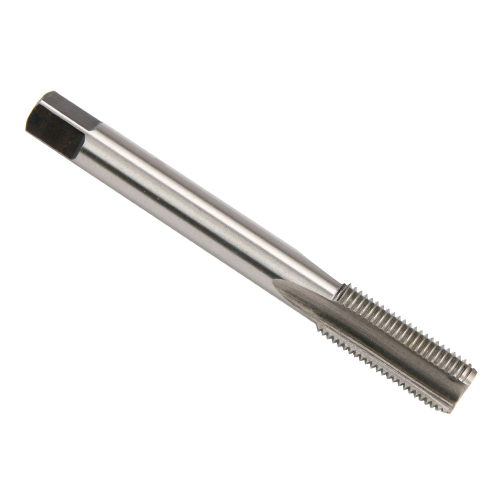

Tap Type: Hand Tap
Thread Size: M3x0.5
Class of Fit: 6H
Thread Limit: D3
Number of Flutes: 3
Chamfer: Plug
Material: High Speed Steel
Thread Direction: Right Hand
Thread Standard: Metric Coarse
Overall Length (Inch): 1.9375" (49.212 mm)
Thread Length (Inch): 0.6250" (15.875 mm)
