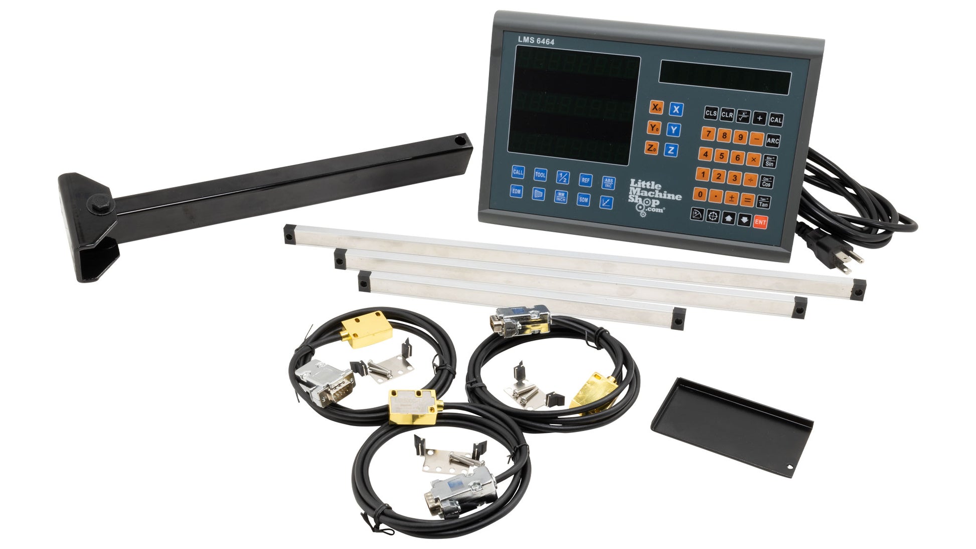

  • Hard wired 3-axis DRO package with mounting arm
  • Designed for LittleMachineShop.com HiTorque bench mills
  • Complete package, no additional components needed

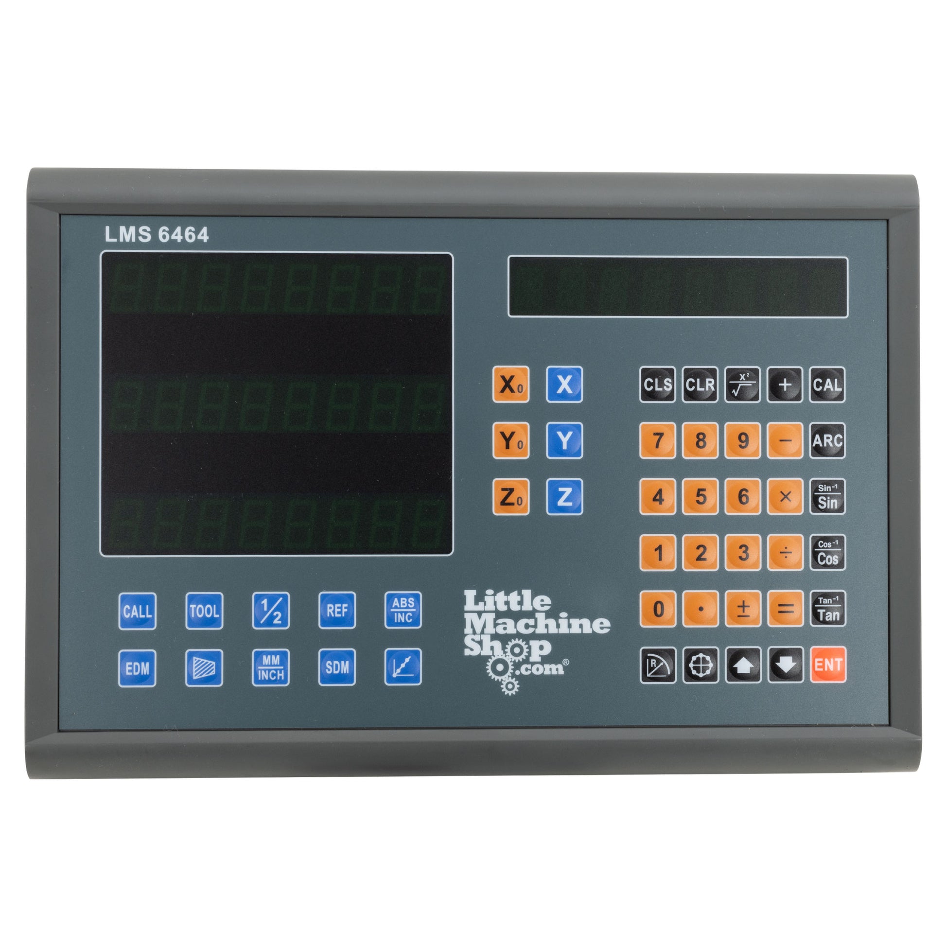

  • Advanced display functions
  • Mounting arm included
Hard wired DRO kit for the HiTorque bench mills. This kit comes with everything you need for a 3-axis bench mill DRO installation.
The wiring setup eliminates the need for a wireless environment and ensures regular steady connectivity to your mill.
The display has a protective cover which can be used or removed based on your preferences.

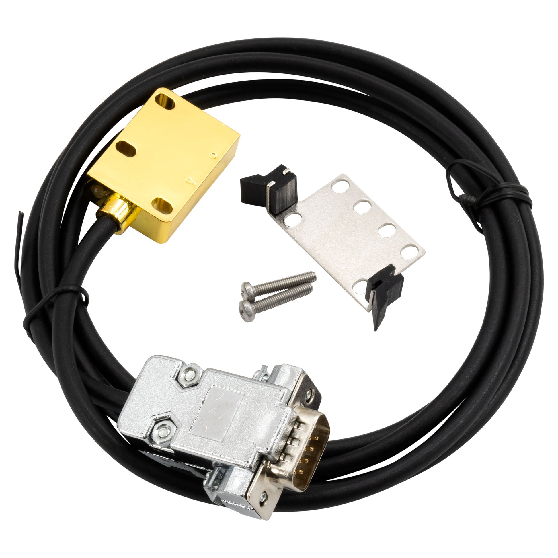

The read head cable is approximately 58" between read head and an 9-Pin connector.
The scales are pre-cut to length for the HiTorque bench mills.
*NOTE: This is not a simple "plug in" accessory that requires installation. Please review the instructions in Chris's Tips before purchase.

Voltage: 120-240 V
Clear to Zero: YES
Direct Entry of Position: YES
Inch/mm Display: YES
Power Off Memory: YES
Reversible Count Direction: YES
Find Center: YES
Bolt Circles: YES
Bolt Lines: YES
Preset Points: YES
Tool Offsets: YES
Radius/Diameter: YES
Incremental/Absolute: YES
Calculator: NO
Arc Machining: NO
Linear Error Compensation: NO
