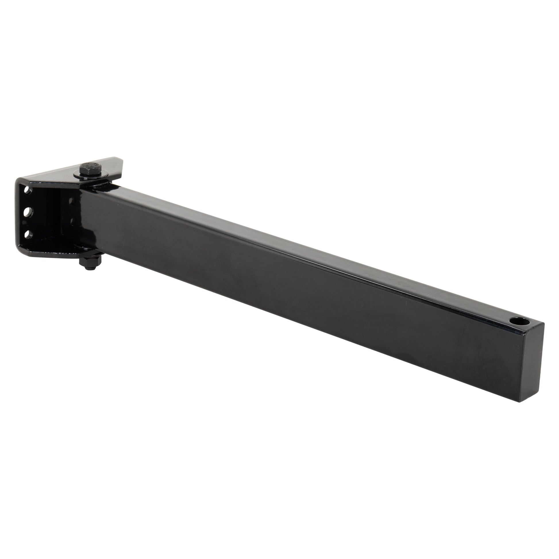

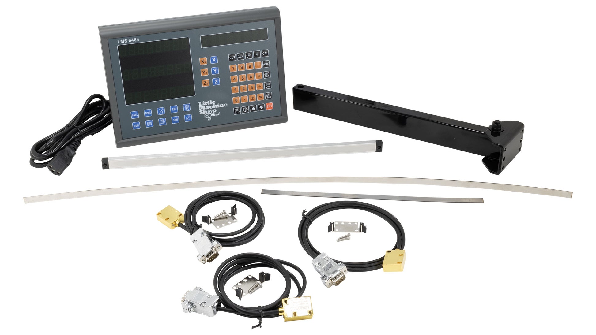

  • Hard wired 3-axis DRO package with mounting arm
  • Designed for LittleMachineShop.com HiTorque large bench mills
  • Complete package, no additional components needed
  • Advanced display functions
  • Mounting arm included
Hard wired DRO kit for the HiTorque large bench mills. This kit comes with everything you need for a 3-axis lrge bench mill DRO installation.
The wiring setup eliminates the need for a wireless environment and ensures regular steady connectivity to your mill.
The display has a protective cover which can be used or removed based on your preferences.
The read head cable is approximately 58" between read head and an 9-Pin connector.
The scales are pre-cut to length for the HiTorque large bench mills.
***NOTE: This is not a simple "plug in" accessory that requires installation. Please review the instructions in Chris's Tips before purchase.
X-Axis Scale Length: 29.528" (750 mm)
Y-Axis Scale Length: 11.811" (300 mm)
Z-Axis Scale Length: 15.354" (390 mm)
Repeatability: 0.000" (0.005 mm)
Resolution: 0.000" (.005 mm)
Specified Accuracy: 0.002" / 1 m travel, 0.05 mm
Accuracy / Foot: 0.002" (.05 mm)
Accuracy / 100 Mm: 0.002" (.05 mm)
Scale Technology: Magnetic
