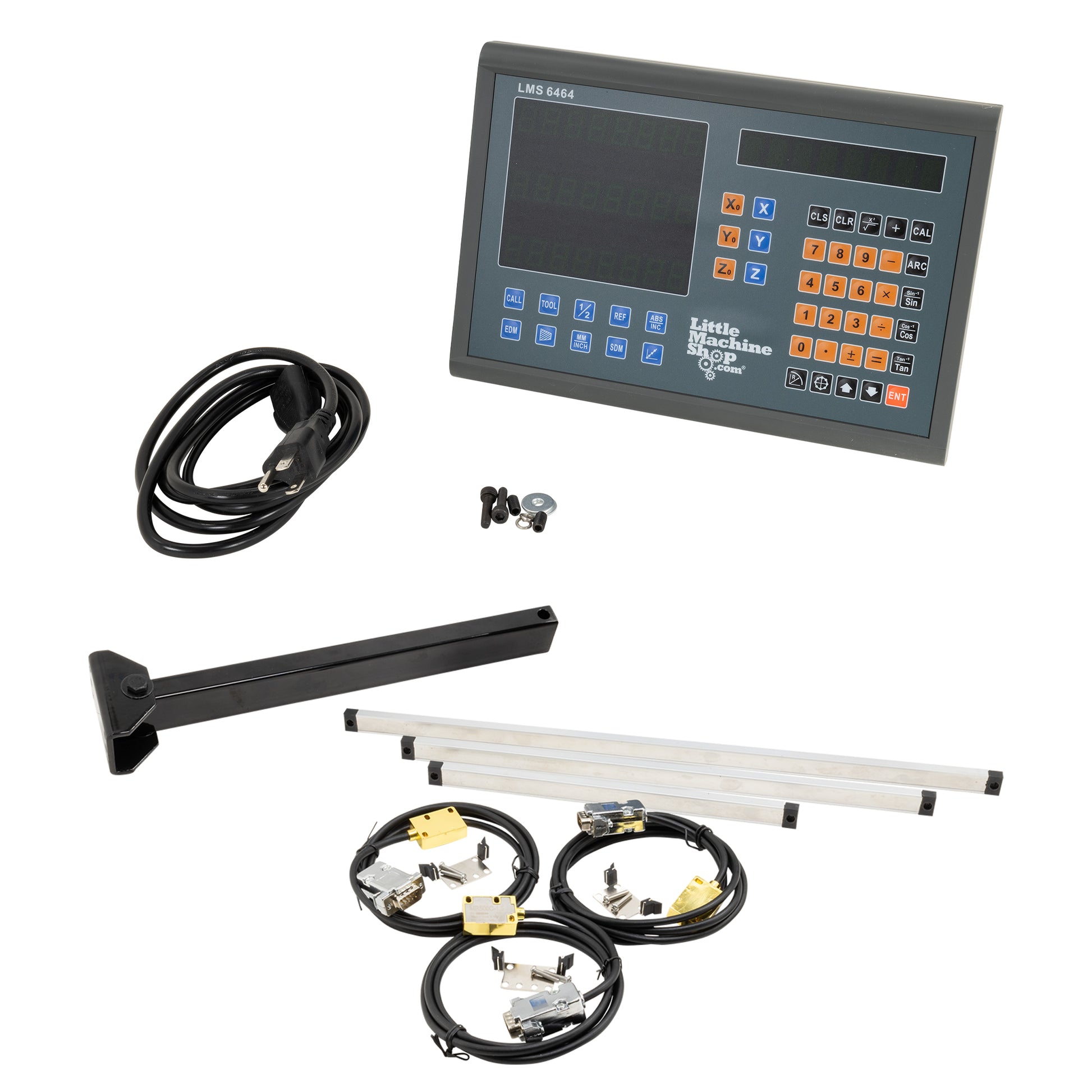

3-Axis DRO Kit, Mini Mill, Hard-wired
Regular price $699.95
Regular price Sale price $699.95
SKU:6864Shelf Location: (BUNDLE)
  • Fits large-table solid column mini mills
  • Dedicated Display
  • Resolution of 0.0002" (0.005 mm)
  • 120 -240 VAC Power supply
  • Coolant and dust resistant (IP50)
This magnetic scale digital readout package fits large-table, solid column mini mills including the HiTorque Mini Mill and the SIEG X2D.

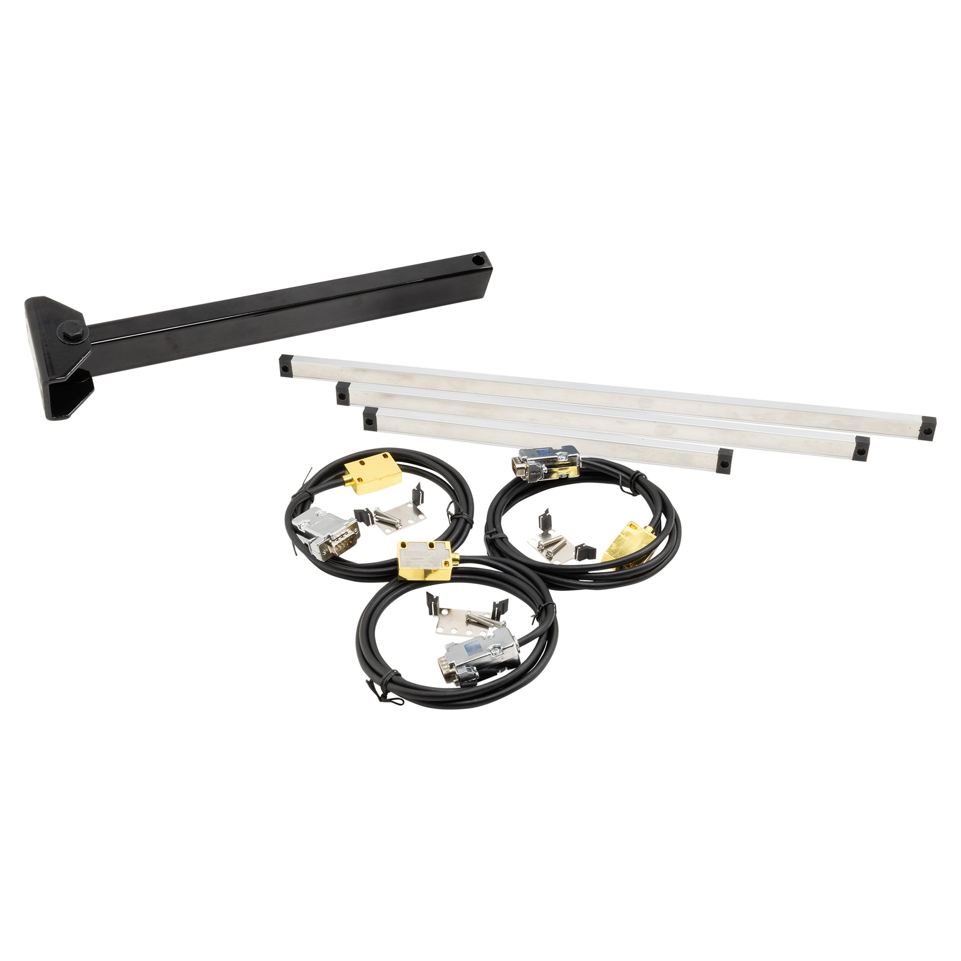

This package includes what you need to put a DRO on most mini mills. It includes three scales, three read heads, a display, and all the mounting brackets and hardware.
Read heads plug into display unit, which can be mounted on the wall or anywhere with the included bracket.
*NOTE: This accessory requires installation involving drilling and tapping holes.
Repeatability: 0.000" (0.005 mm)
Resolution: 0.000" (.005 mm)
Specified Accuracy: 0.002" / 1 m travel, 0.05 mm
Accuracy / Foot: 0.002" (.05 mm)
Accuracy / 100 Mm: 0.002" (.05 mm)
Scales Cut to Length by User: YES
Scale Technology: Magnetic
Scale Protection: Coolant & dust resistant
Voltage: 100-240 V
Clear to Zero: YES
Direct Entry of Position: YES
Inch/mm Display: YES
Power Off Memory: NO
Reversible Count Direction: YES
Find Center: YES
Bolt Circles: YES
Bolt Lines: YES
Preset Points: YES
Tool Offsets: YES
Radius/Diameter: YES
Incremental/Absolute: YES
Calculator: NO
Arc Machining: NO
Linear Error Compensation: NO
Made In: China
Warranty: 1 year
