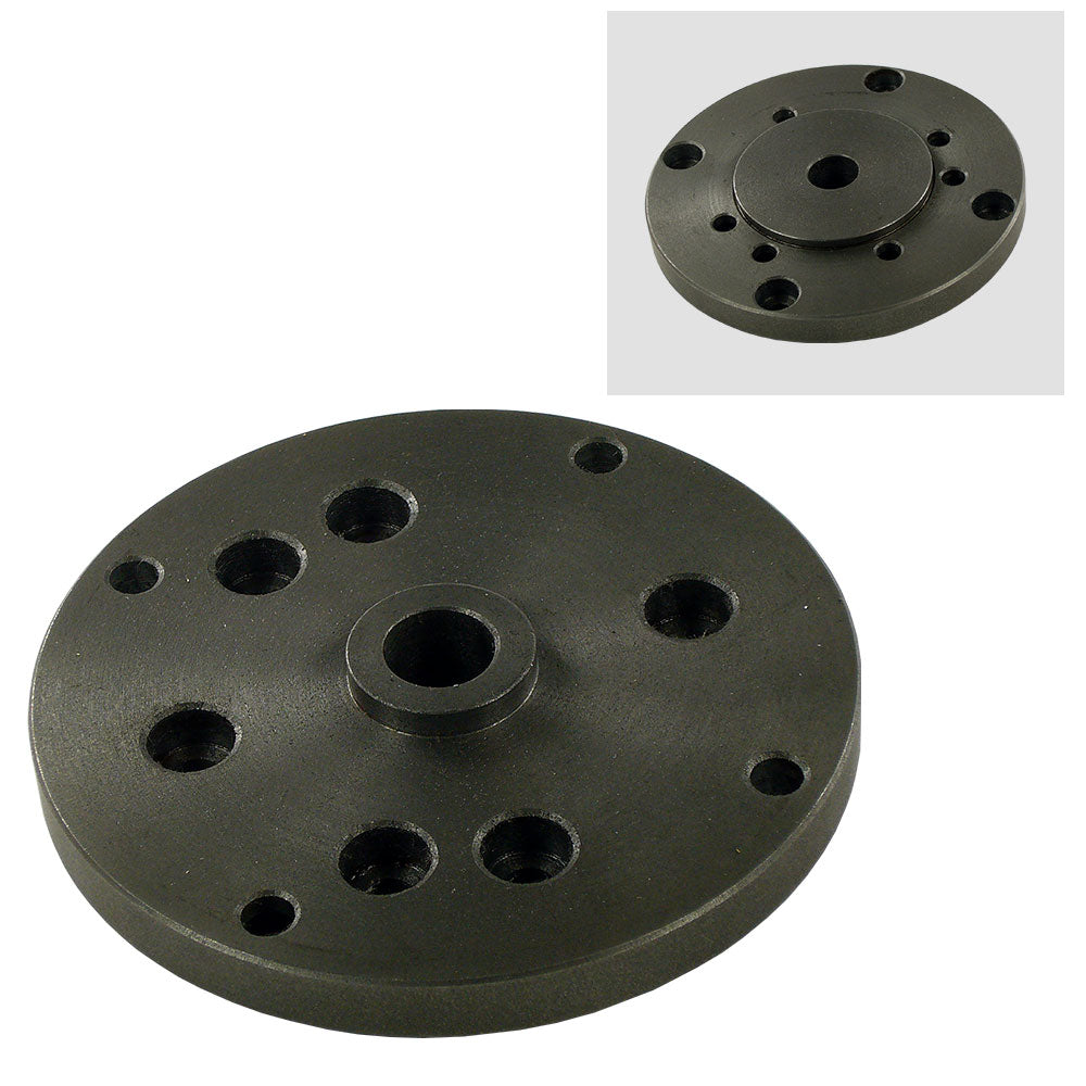

  • For rotary tables with 24 mm registration hole in center
  • This adapter is included with the 1810 rotary table and 2183 rotary table package
  • Use with a 3" 3- or 4-jaw lathe chuck
  • Compatible with rotary table with 2 Morse taper center hole
3" Lathe chuck adapter.
This adapter lets you mount a 3" 3- or 4-jaw lathe chuck on a rotary table with a 2 Morse taper center hole. There is an alignment boss that projects into the tapered hole for quick alignment. It is clamped to the rotary table with T-slot nuts that are not included.
You will need to machine the alignment boss to fit your rotary table.
Outside Diameter: Ø 3.937",100 mm
Center Hole: Ø 0.551",14 mm
Table Side Registration Boss: Ø 0.945",24 mm
Table Side Bolt Circle: Ø 3.583",91 mm
Adapter Mounting Holes: 4
Chuck Side Registration Boss: Ø 2.165",55 mm
Chuck Side Bolt Circle: Ø 2.598",66 mm
Chuck Mounting Holes: 6
