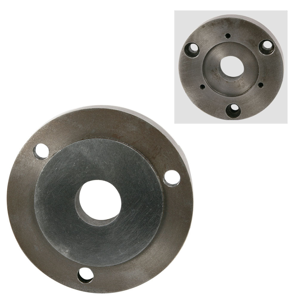

  • Compatible with 4" 3-Jaw Lathe Chuck on Mini Lathes
  • Use with Chucks with a 70 mm Registration Recess Diameter
  • Works on Spindles with Only 3 Holes
  • Fits Bison 4" 3-Jaw chucks
This adapter lets you mount a 4" 3-jaw lathe chuck on your mini lathe.
Use this adapter with chucks that have a 70 mm registration recess diameter such as Bison 4" 3-Jaw chucks.
The adapter mounts to the 3-hole pattern on the spindle so it works on spindles with only three holes.
Outside Diameter: Ø 3.937",100 mm
Center Hole: Ø 0.984", 25 mm
Spindle Side Registration Recess: Ø 2.165",55 mm
Spindle Side Bold Circle: Ø 2.598",66 mm
Chuck Side Registration Boss: Ø 2.756",70 mm
Chuck Side Bolt Circle: Ø 3.268",83 mm
Chuck Mounting Holes: 6
