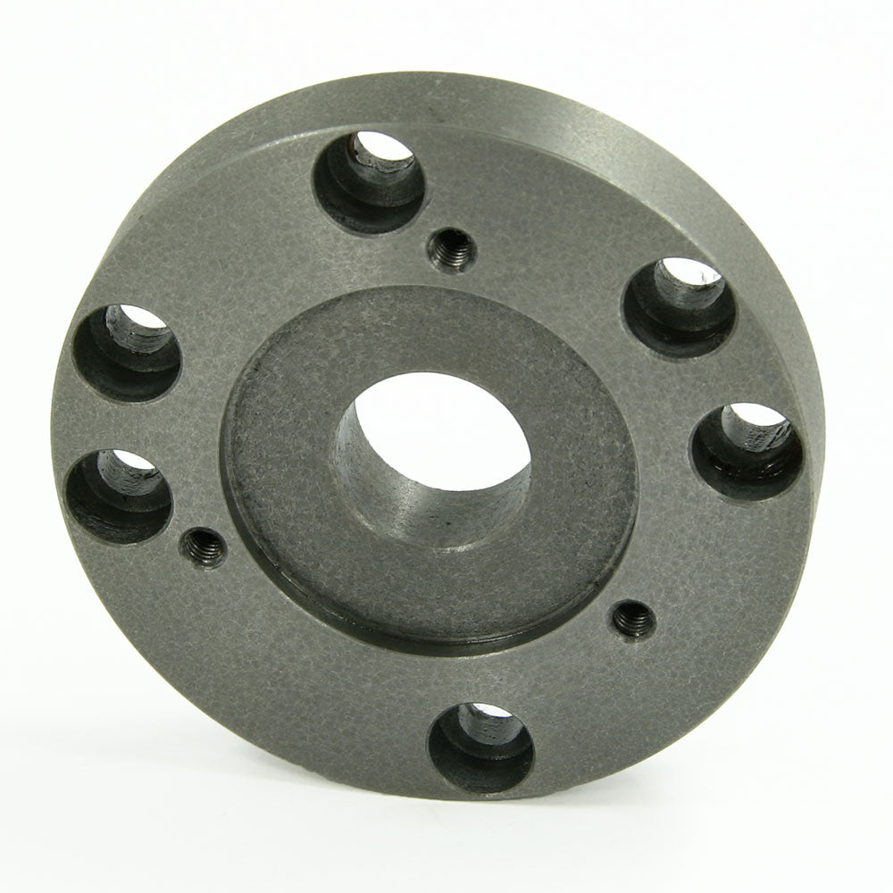

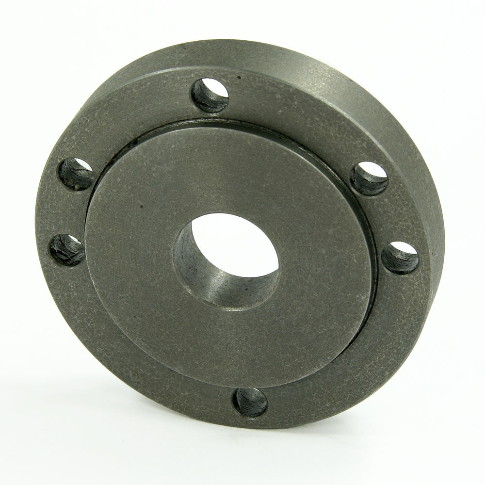

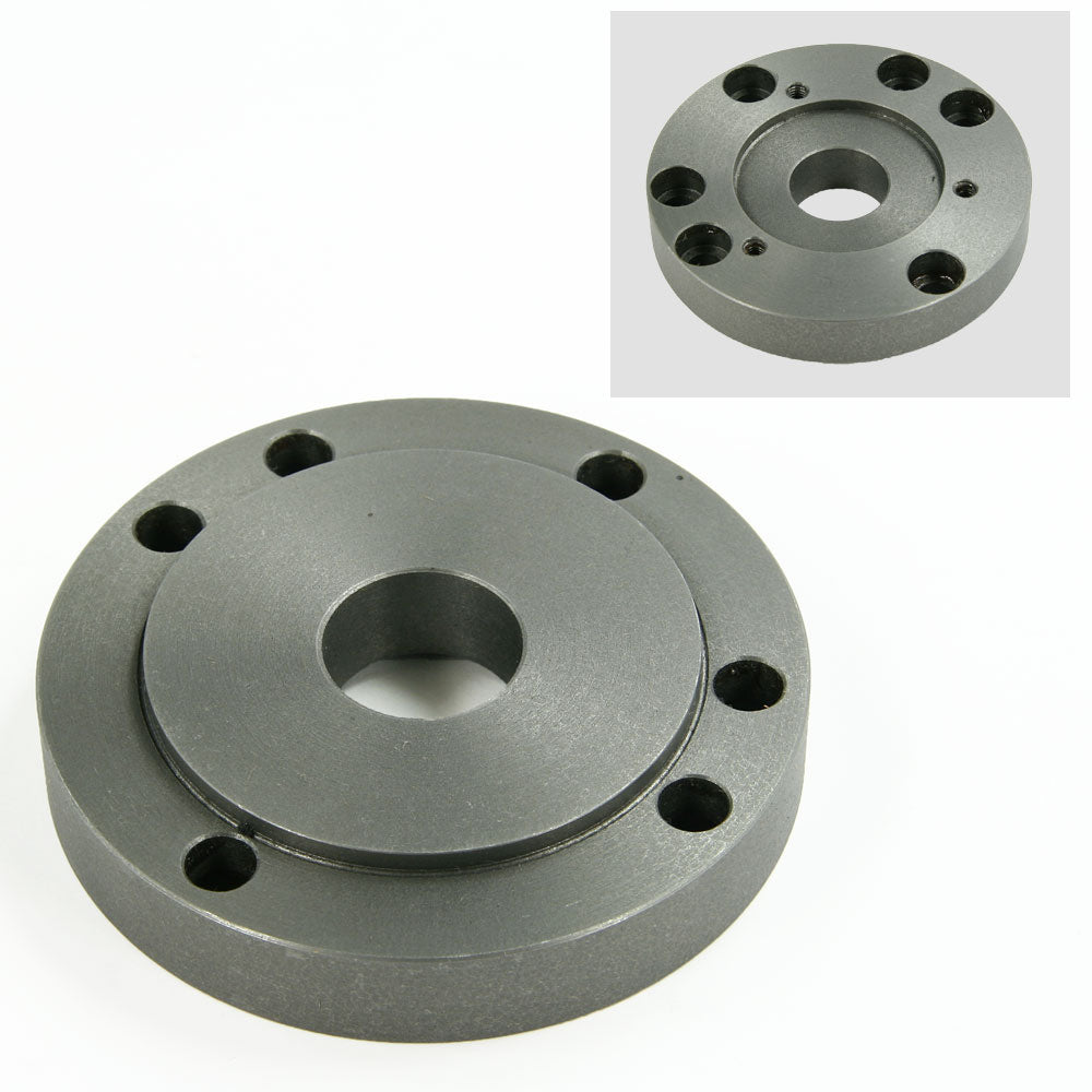

This adapter lets you mount 4" 3- or 4-jaw lathe chucks on your mini lathe.
Use this adapter with chucks that have a 72 mm registration recess diameter.
The adapter mounts to the 3-hole pattern on the spindle so it works on spindles with only three holes.
This adapter is cast iron and has a net thickness of 0.66". The net thickness is the distance from the rim of the lathe spindle to the back of the chuck.
* Note Don't forget to purchase the appropriate set of Studs & Nuts to accommodate changes in chuck or adapter configurations.
Outside Diameter: Ø 3.937",100 mm
Center Hole: Ø 0.984", 25 mm
Spindle Side Registration Recess: Ø 2.165",55 mm
Spindle Side Bold Circle: Ø 2.598",66 mm
Spindle Side Stud Thread: M6
Chuck Side Registration Boss: Ø 2.835",72 mm
Chuck Side Bolt Circle: Ø 3.307",84 mm
Chuck Mounting Holes: 3-bolt & 4-bolt patterns
