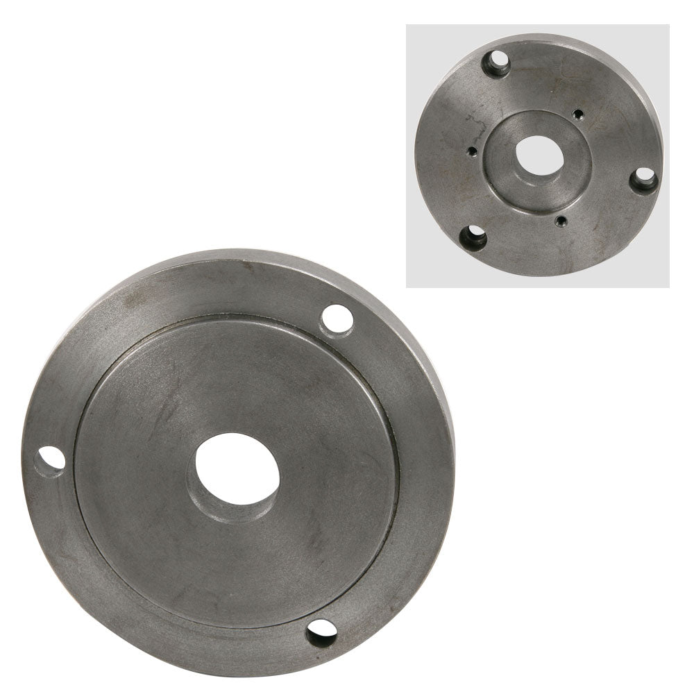

  • Compatible with 5" 3-Jaw Lathe Chucks
  • Can Use on Mini Lathe with 5" Chuck in Place of 3" Chuck
  • 92 mm Diameter Registration Boss
  • 3 Chuck Mounting Holes
This adapter lets you mount 5" 3-jaw lathe chucks on your mini lathe in place of a 3" (80 mm) chuck.
The adapter mounts to the 3-hole pattern on the spindle so it works on spindles with only three holes.
This adapter has a 92 mm diameter registration boss, and has 3 chuck mounting holes.
NOTE: It is an uncommon size for plain back chucks. Typically, a 5" plain back chuck will have a 95mm registration recess.
* Note Don't forget to purchase the appropriate set of Studs & Nuts to accommodate changes in chuck or adapter configurations.
Outside Diameter: Ø 4.921",125 mm
Center Hole: Ø 1.181", 30 mm
Spindle Side Registration Recess: Ø 2.165",55 mm
Spindle Side Bold Circle: Ø 2.598",66 mm
Chuck Side Registration Boss: Ø 3.622",92 mm
Chuck Side Bolt Circle: Ø 4.252",108 mm
Chuck Mounting Holes: 3
