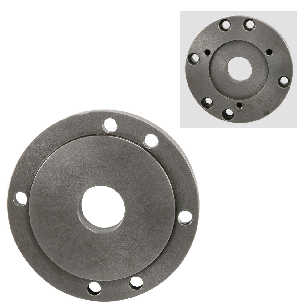

- Compatible with 5" 3- or 4-Jaw Lathe Chucks
- Can Use to Mount 125 mm Chuck on 100 mm Flange
Flange to mount 125 mm chuck on 100 mm flange on Prazi lathes.
Works with Prazi 2400DLX and Wabeco 2400 lathes.
Outside Diameter: Ø 4.921",125 mm
Center Hole: Ø 1.181", 30 mm
Spindle Side Registration Recess: Ø 2.756",70 mm
Spindle Side Bold Circle: Ø 3.268",83 mm
Chuck Side Registration Boss: Ø 3.740",95 mm
Chuck Side Bolt Circle: Ø 4.252",108 mm
Chuck Mounting Holes: 6
