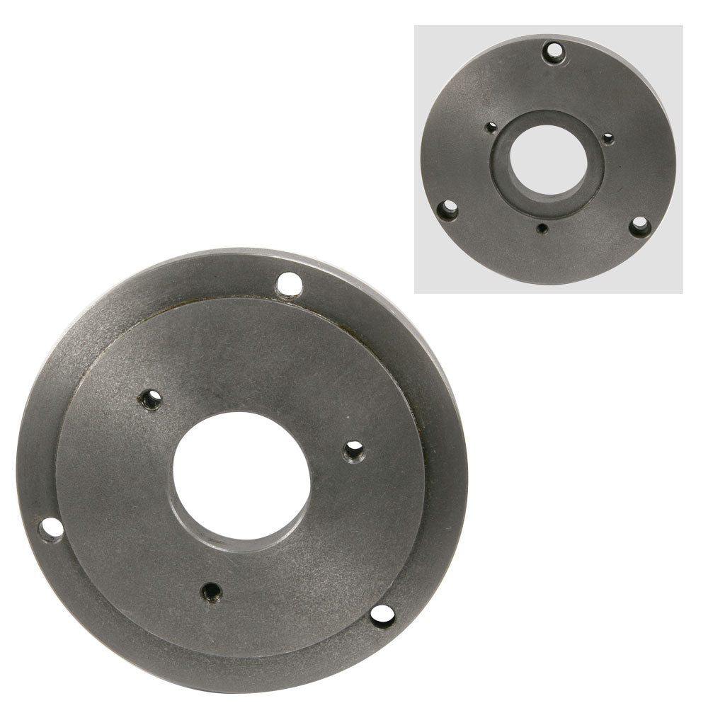

  • Fits 6" 3-Jaw Lathe Chucks with 130 mm Registration Recess
  • Can Use with 6" Chuck on a Flange for 4" Chuck with 72 mm Registration Boss
  • Works on 8x12 and 8x14 Lathes
This adapter mounts a 6" 3-jaw lathe chuck with a 130 mm registration recess on a flange for a 4" chuck with a 72 mm registration boss. It works on 8x12 and 8x14 lathes as well as the Harbor Freight 5980 multipurpose machine. It also fits the SIEG C4 and SC4 lathes.
*NOTE: If using with any of our 6" 4-jaw chucks (2038, 6547) additional mounting holes will need to be drilled. Use M8 transfer screws to mark holes for the 2038 chuck.
* Note Don't forget to purchase the appropriate set of Studs & Nuts to accommodate changes in chuck or adapter configurations.
Outside Diameter: Ø 6.496",165 mm
Center Hole: Ø 1.969", 50 mm
Spindle Side Registration Recess: Ø 2.835",72 mm
Spindle Side Bolt Circle: Ø 3.307",84 mm
Chuck Side Registration Boss: Ø 5.118",130 mm
Chuck Side Bolt Circle: Ø 5.591",142 mm
Chuck Mounting Holes: 3
