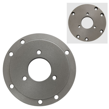

  • Fits 6" 3-Jaw and 4-Jaw Lathe Chucks
  • Designed specifically for the HiTorque 9x20 bench lathe.
This adapter mounts to a 6" 3-jaw or 4-jaw lathe chucks with a 3-bolt pattern or 4-bolt pattern and 142mm bolt circle. The adapter has no spindle side registration recess and is designed specifically for the HiTorque 9x20 lathe spindle. It has a 52mm center hole.
* NOTE: Also includes (3) Studs for 9x 20 chuck adapter (6739) required for mounting on to lathe spindle flange.
Outside Diameter: Ø 6.299",160 mm
Center Hole: Ø 2.047", 52 mm
Spindle Side Registration Recess: None
Spindle Side Bolt Circle: Ø 2.953",75 mm
Chuck Side Registration Boss: Ø 5.118",130 mm
Chuck Side Bolt Circle: Ø 5.591",142 mm
Chuck Mounting Holes: 6
