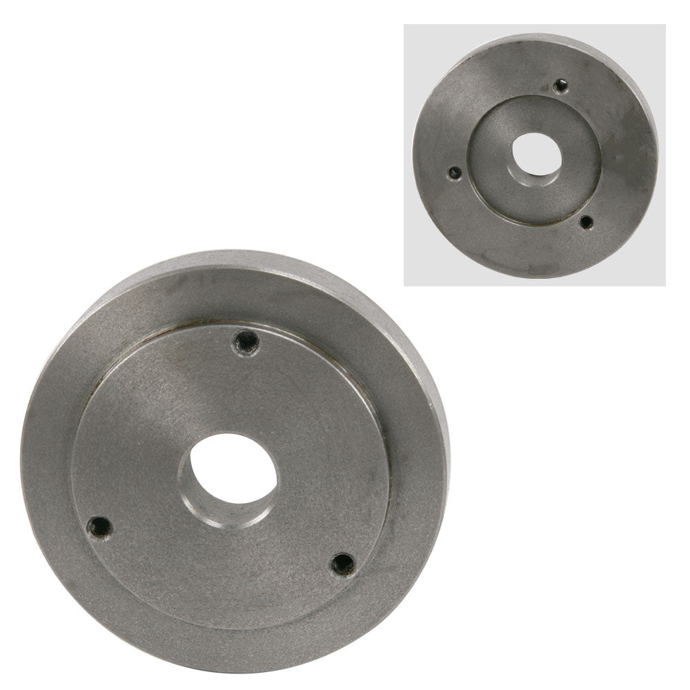

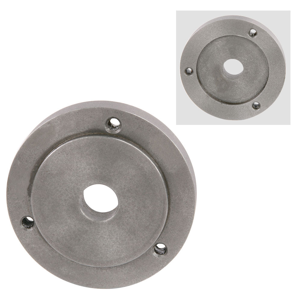

  • Fits a 5" chuck on a 4" flange
This is a semi-machined adapter plate. The side that attaches to the lathe flange is fully machined. The side on which the lathe chuck mounts is not finished.
Mount the backplate adapter on your lathe and complete machining of the chuck-mounting side. This ensures two things; that it will fit your chuck, and that it is concentric on your lathe.
* Note Don't forget to purchase the appropriate set of Studs & Nuts to accommodate changes in chuck or adapter configurations.
Outside Diameter: Ø 4.921",125 mm
Center Hole: Ø 1.260", 32 mm
Spindle Side Registration Recess: Ø 2.835",72 mm
Spindle Side Bolt Circle: Ø 3.307",84 mm
Chuck Side Registration Boss: Ø 3.780",96 mm
Chuck Mounting Holes: None
