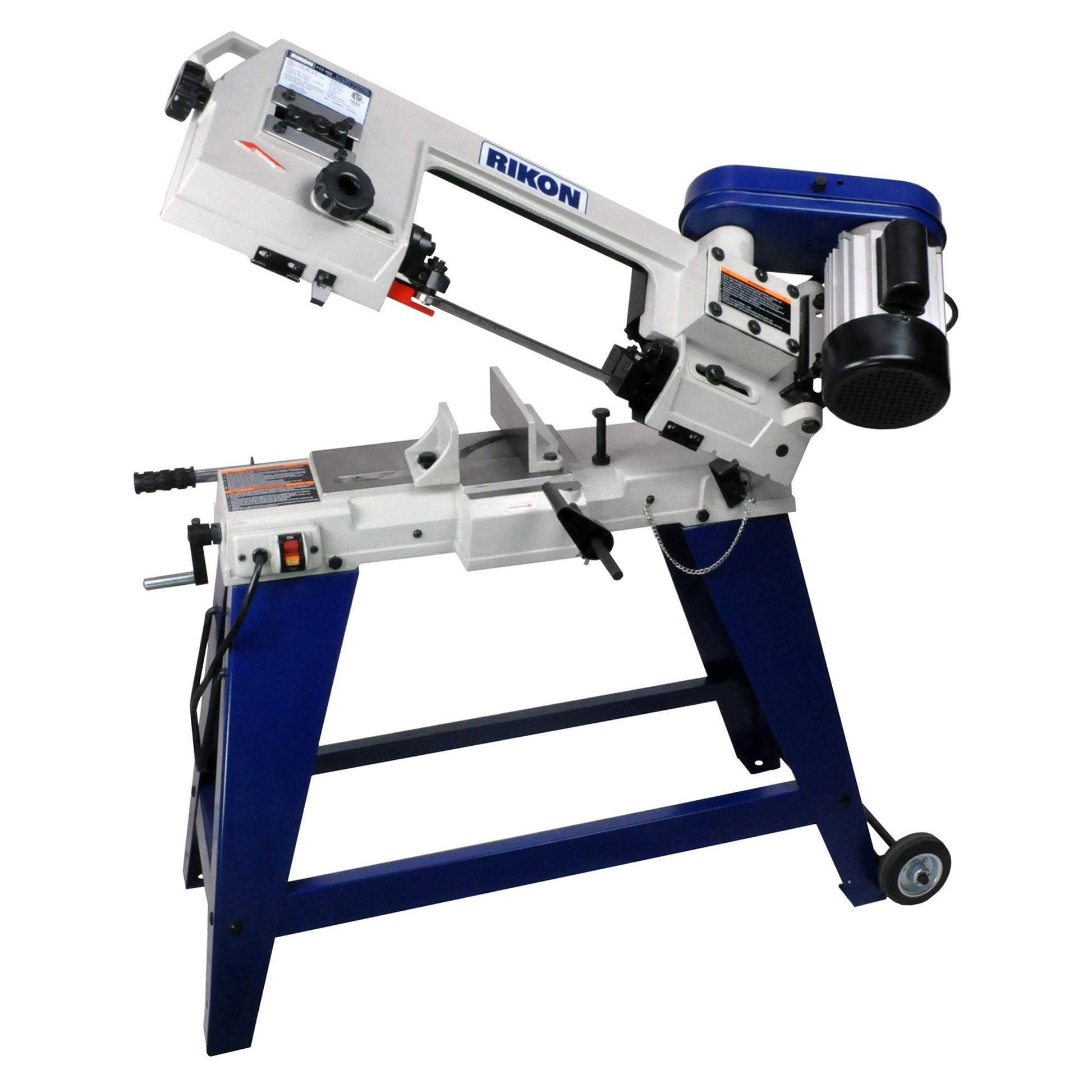

  • Floor standing band saw, 4x6, Model 15-400 - Rikon
  • Horizontal position for precise cutting and automatic shutoff

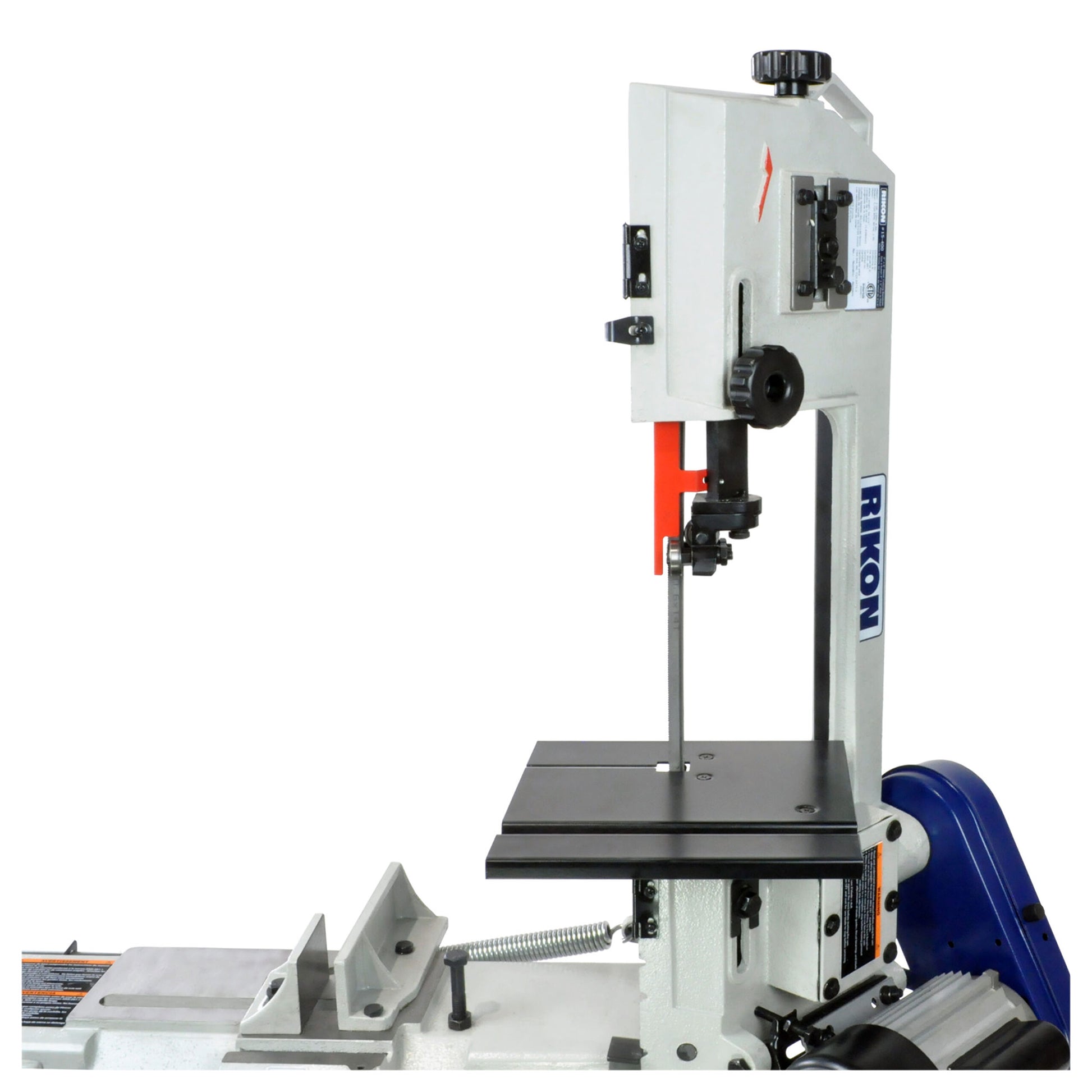

  • Vertical position for freehand cutting

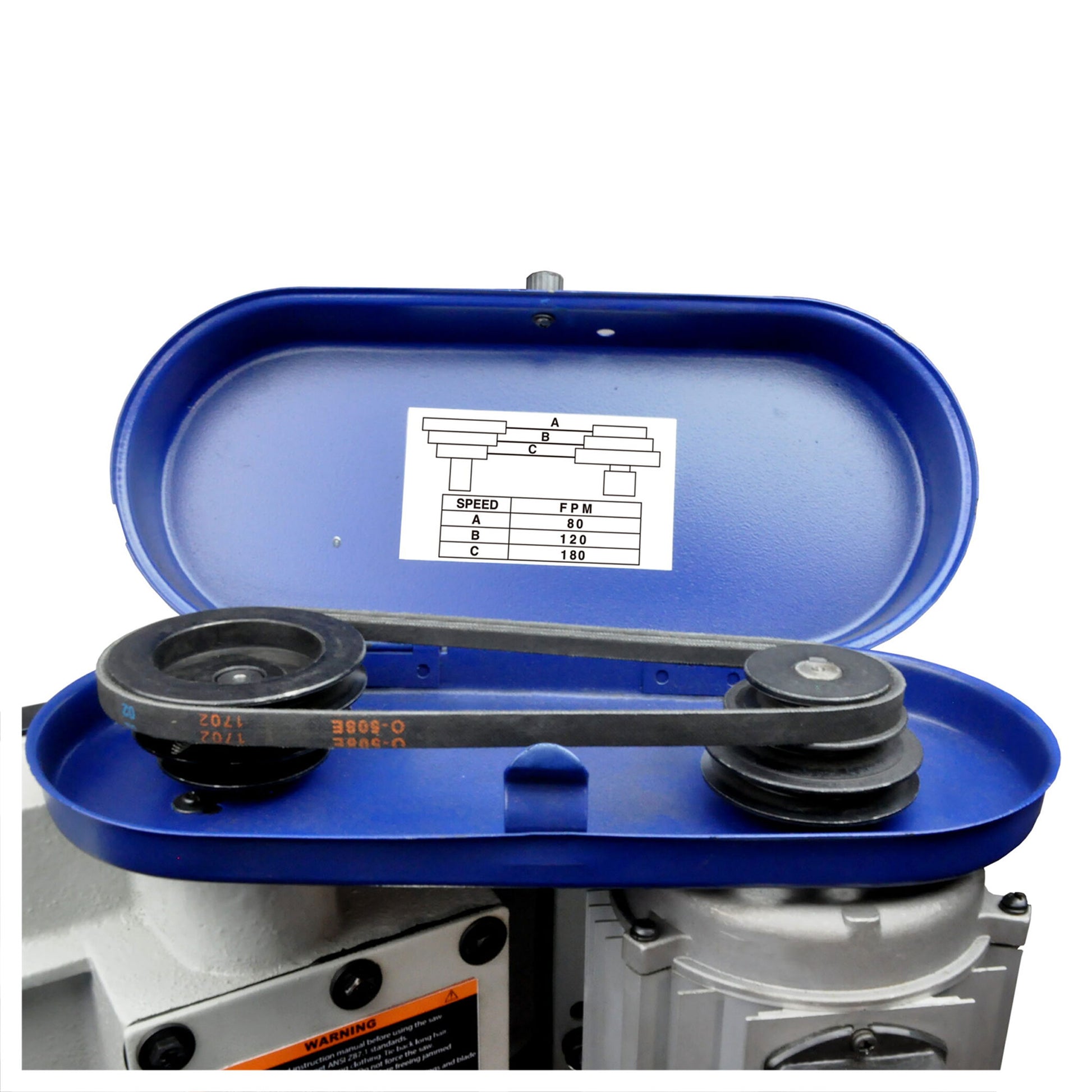

  • 3 blade speeds: 80, 120, and 180 feet per minute

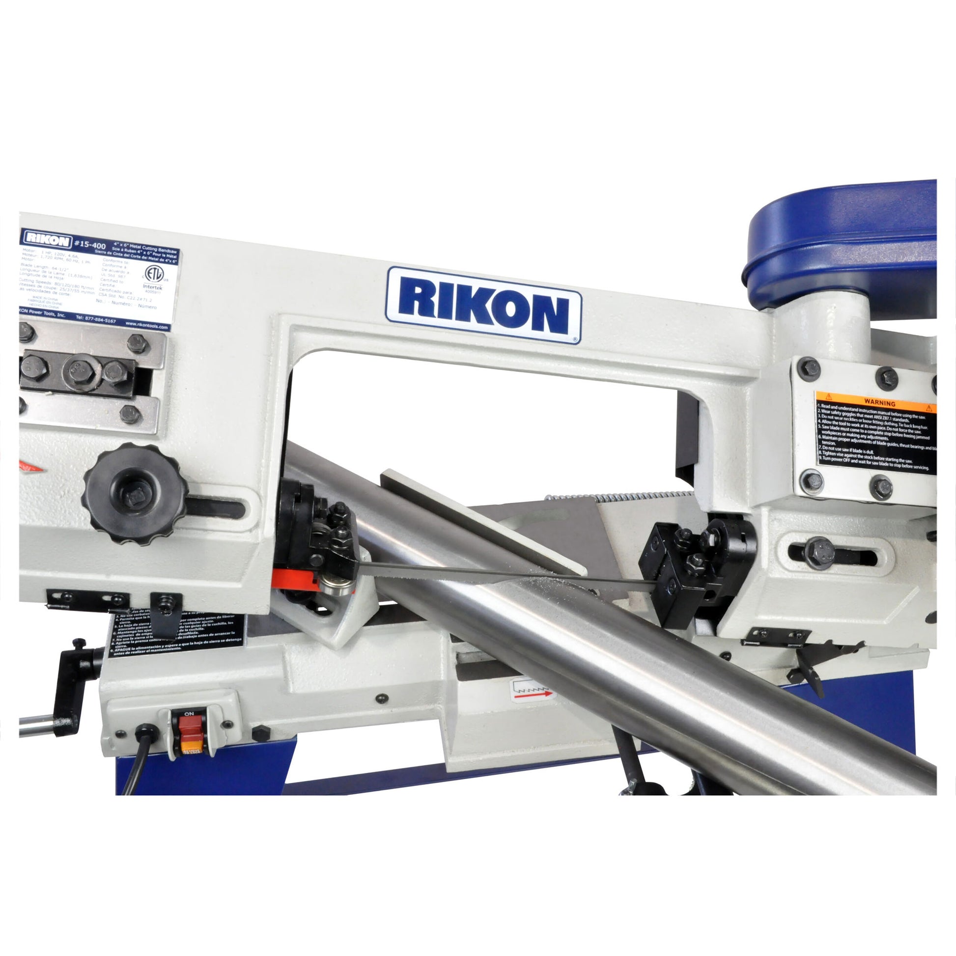

  • 4" x 6" rectangular capacity or 4-1/2" round stock capacity
Equipped with three speed settings and a 1/2'' blade, this saw will cut everything from soft brass alloys to stainless steel. Set the saw horizontally, or tilt it up and install the included table for use as a vertical bandsaw. Its powerful 3/4HP motor and rugged cast iron frame and bed ensure solid performance for all your metal-cutting needs.
  • Powerful 3/4HP TEFC motor, prewired for 120 volts
  • Handles stock up to 4'' x 6'' square and 4-1/2'' round
  • Cuts miters up to 45°
  • Built-in angle vise lets you clamp stock securely at any angle up to 45°

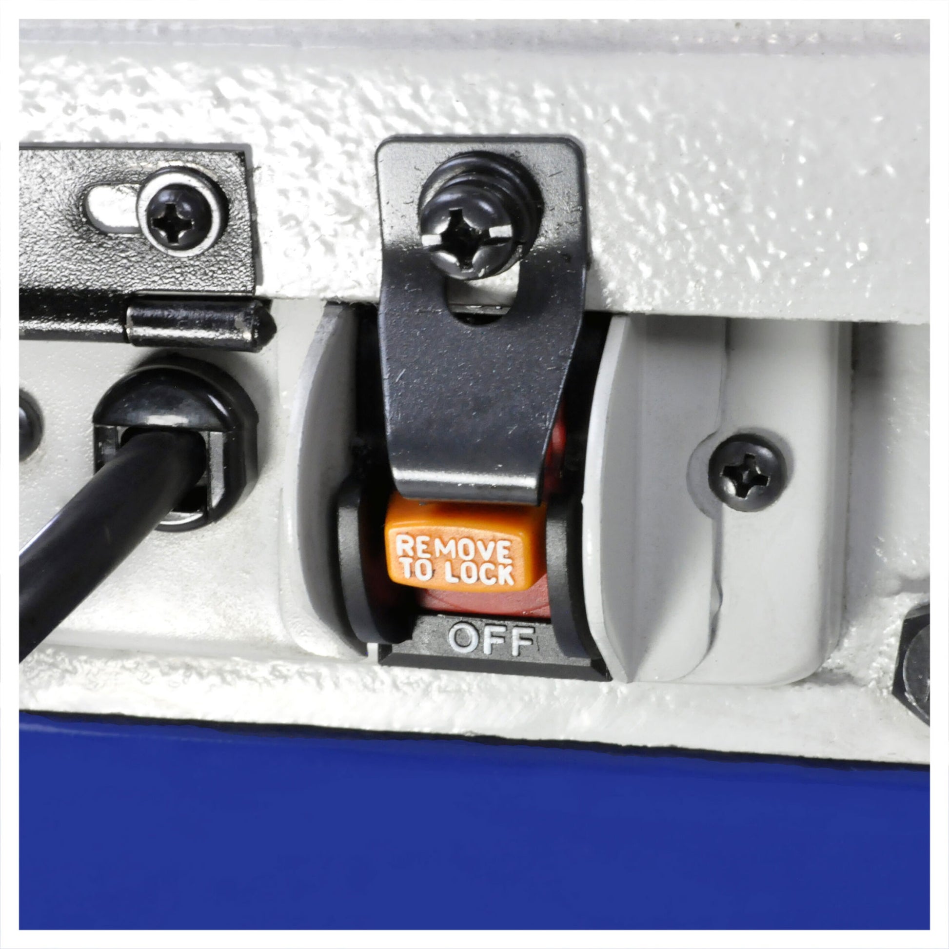

  • Auto-off switch function shuts off when a cutting operation is completed
  • Use horizontally or vertically when the included table is installed
  • Three speeds optimize cutting performance for everything from brass alloys to stainless steel
  • Blade can be fed into material manually or hands-free with a spring-assist torsion system
  • Wheeled stand makes saw easier to move around the shop
*NOTE: This is Rikon model 15-400

Our 4x6 band saw has three speeds. Use low speed for high strength steel, stainless steel, and other harder materials. Use the medium steel for mild steel including structrual shapes. Use high speed for aluminum and other non-ferrous metals. High speed works well for wood and plastic, too.
