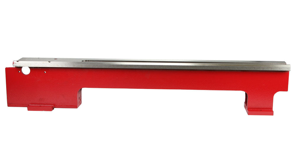

Bed Way 16"
Bed Way 16"
Regular price $129.95
Regular price Sale price $129.95
Out of stock
SKU:4987Shelf Location: (P03 - 01)
This is the bed way for the 7x16 mini lathe bed extension kit.
You must drill and tap 9 holes in the new bed casting to match your lathe. You need three metric taps: M3x0.5, M6x1, and M8x1.25. If you don't have metric drills, you can use letter and number drills for tap drills.
If you don't have the metric taps required, we have a tap and tap drill kit that has just what you need to install this kit.
