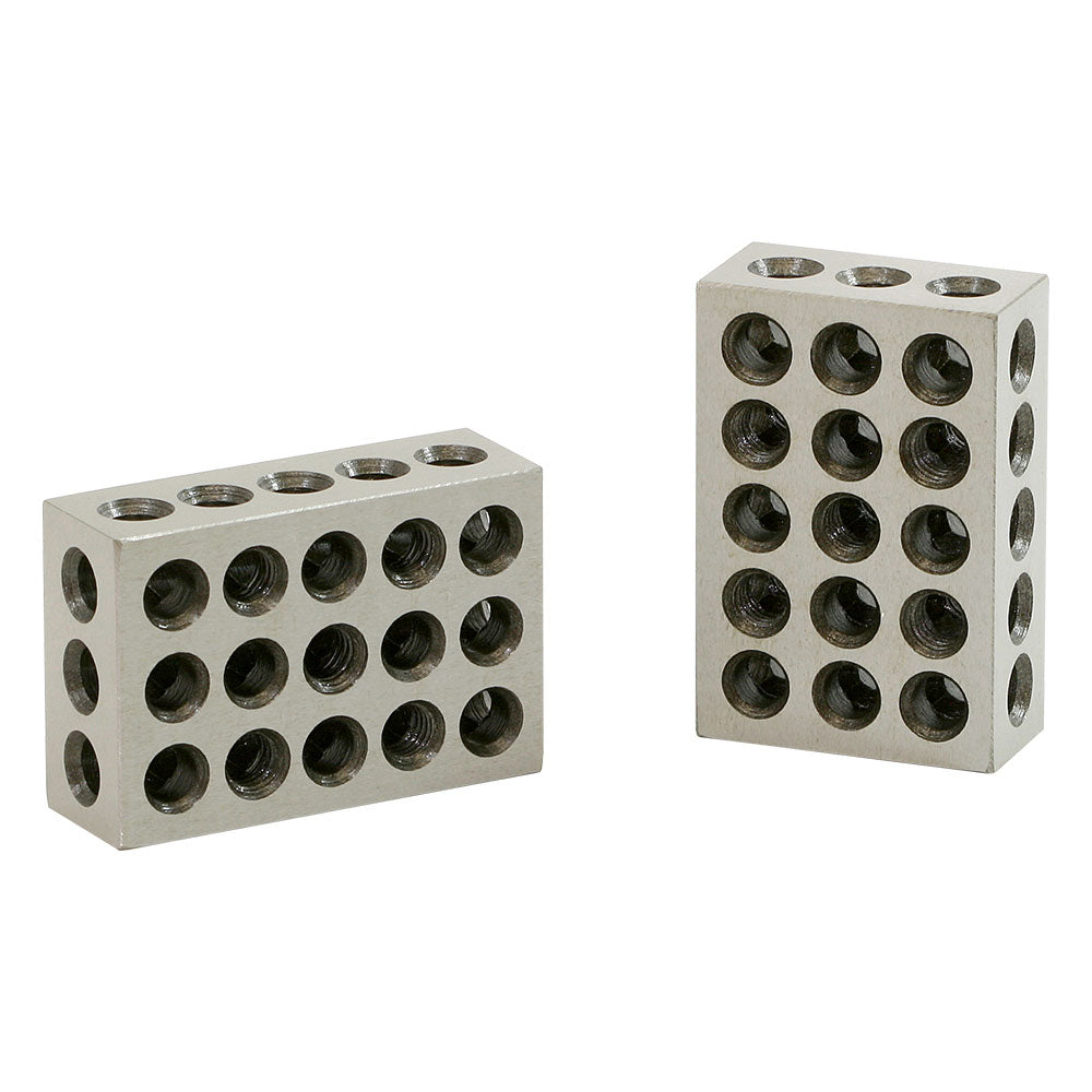

  • Threaded holes are 3/8"-16 thread
  • Through holes are 5/16"
  • Hardened and precision ground steel
  • Pairs are matched within 0.0002"
These precision 1-2-3 blocks are precision ground and case hardened on all sides to 50-60 Rc.
Each set includes two matched blocks. The blocks are 1" by 2" by 3". They are parallel within 0.0002", flat within 0.0002" and square within 0.0002".
The blocks have 23 holes through them, 5 are threaded 3/8"-16 NC, and the other through holes are 5/16" diameter.
These blocks have a myriad of uses, including, but not limited to:
  • Use as parallels: Set your large workpiece on 1-2-3 blocks and clamp it to the table so you can drill through holes without damaging your mill table.
  • Use as fixtures: 1-2-3 blocks can be clamped to a machine table and used to create a repeating set-up for machining identical parts.
  • Check your calipers: Since 1-2-3 blocks are made to tight tolerances, they can be used to verify the accuracy of your calipers.
  • Use for measuring: Hold a 1-2-3 block against your workpiece to make a protruding edge that you can measure to.
