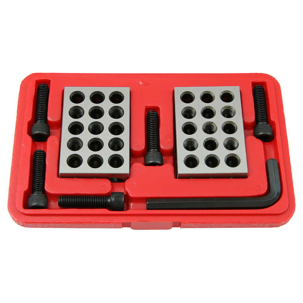

  • Threaded holes are 3/8"-16 thread
  • Through holes are 5/16"

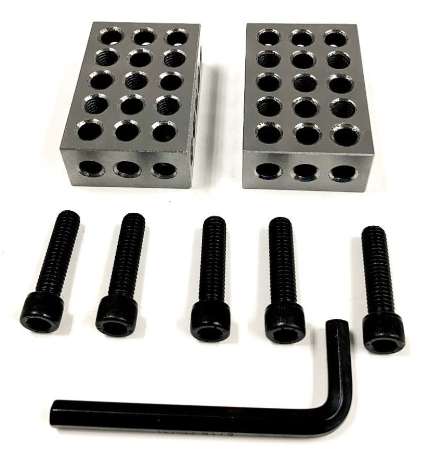

  • Pair of 1-2-3 blocks
  • Five 3/8"-16 x 1-1/2" Socket Head Cap Screws
  • One Hex Wrench

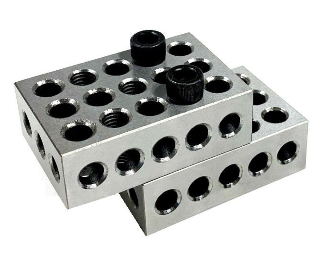

1-2-3 blocks provide a precise, stable, and reusable reference for ensuring accuracy in machining, inspection, and layout tasks, making them a staple in all machine shops.
These ultra precision 1-2-3 blocks are parallel within 0.0001", flat within 0.0001" and square within 0.0001". They are up to 0.0003" oversize for lapping.
Each set includes two matched blocks.
  • The blocks have 23 holes through them. Five are threaded 3/8-16 NC, and the other through holes are 5/16" diameter.
  • The set includes a matched pair of 1-2-3 blocks, five 3/8-16 x 1.5" socket head cap screws and a hex wrench.
  • Blocks are ground and case hardened on all sides to 55-60 Rc.

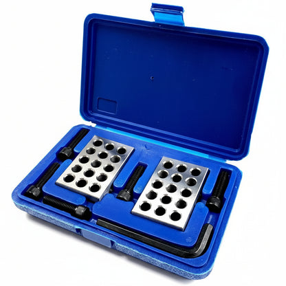

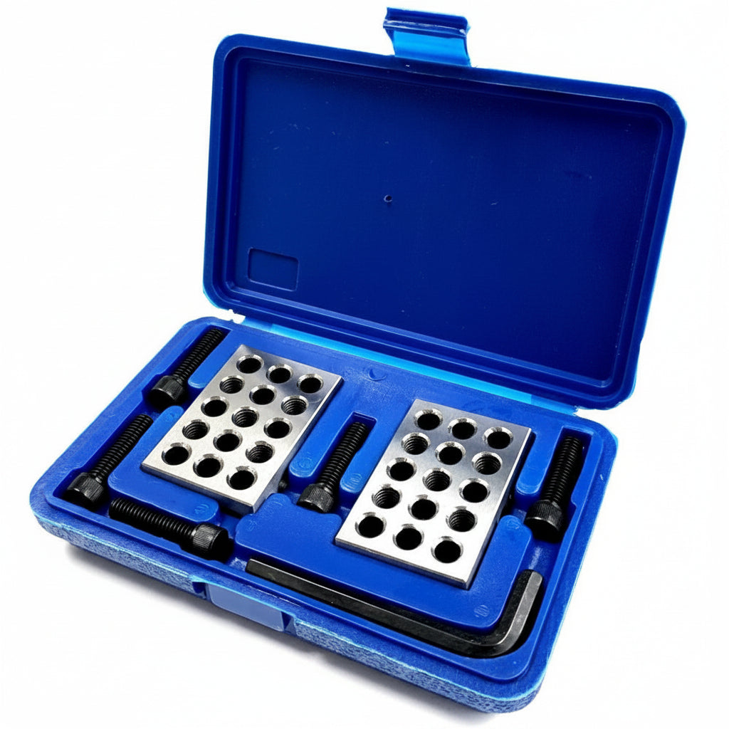

Furnished in a fitted case.
