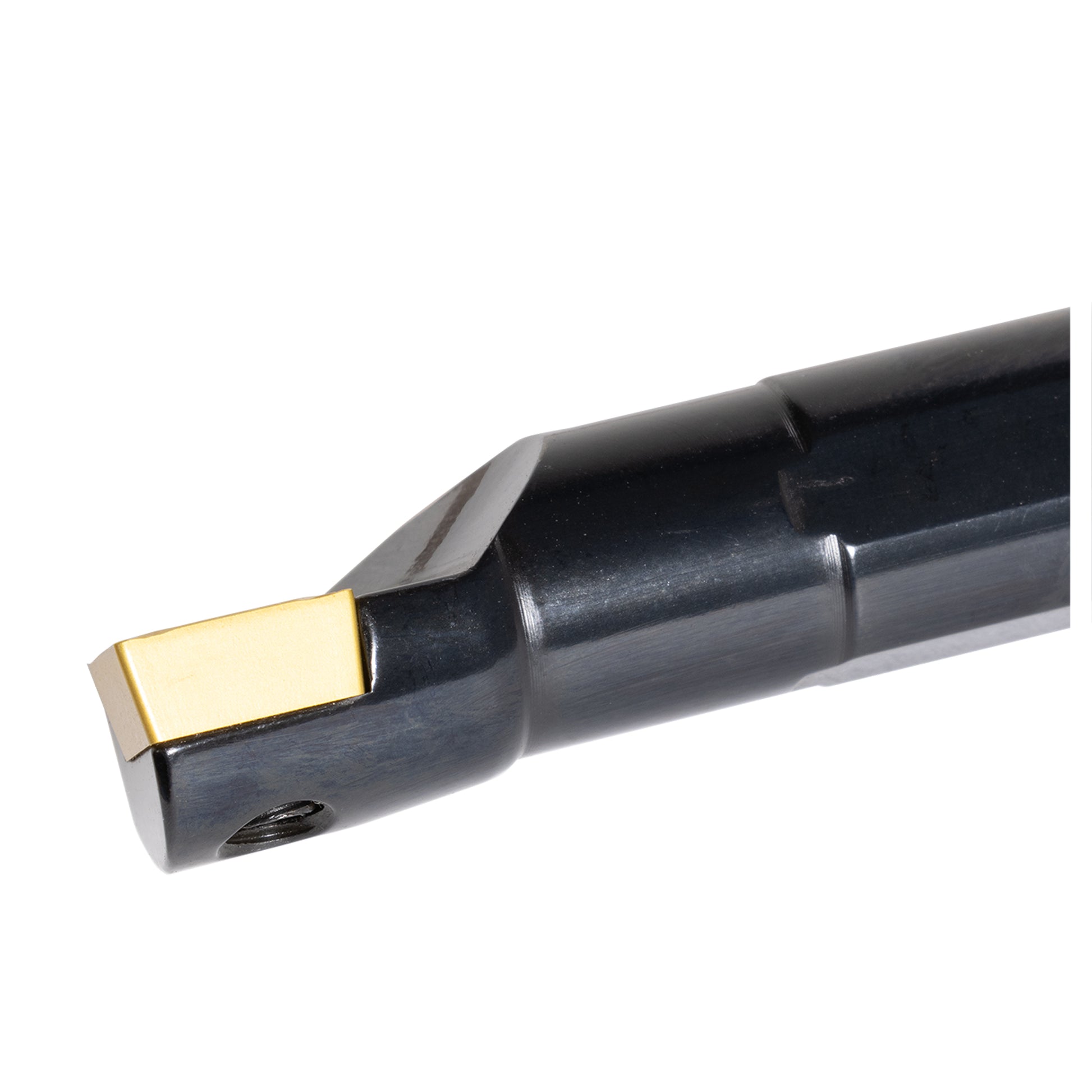

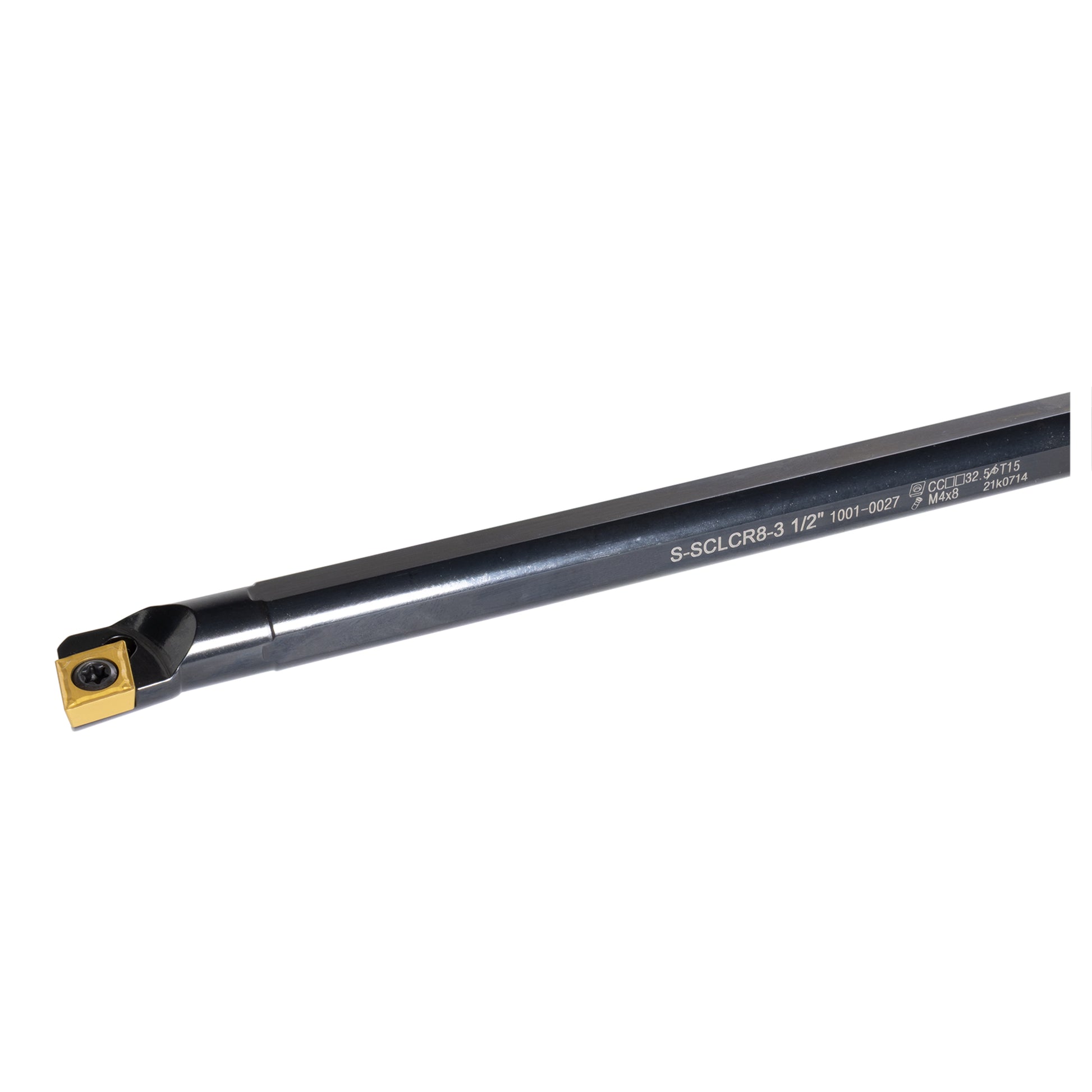

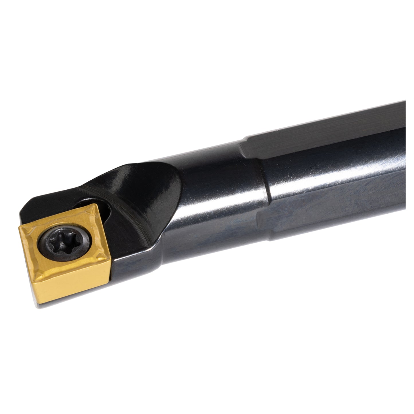

  • Profiling bars for semi-finishing and finishing operations
  • Designed for CCMT 80° inserts
  • 7° Relief angle
  • Negative 5° Lead angle for boring
  • 3° Side & end cutting edge angle
This 1/2" diameter indexable boring bar uses CCMT inserts.
Minimum bore diameter is 0.625"
Use CCMT 32.51 or CCMT 32.52 inserts with this boring bar.
Carbide cutting tools are a hard composite material , primarily tungsten carbide, bonded with cobalt. They can withstand extreme temperatures (up to 1,000° C) and heavy mechanical loads without losing their hardness.
Many of our carbide inserts are coated, typically with TiN (Titanium Nitride). This coating reduces friction and improves wear resistance.
Overall Length: 6" (152.400 mm)
Diameter: .5" (12.700 mm)
Minimum Bore: 0.625" (15.875 mm)
Ccmt Inserts: 80°
Replacement Inserts: CCMT-32.51 or CCMT-32.52
Relief Angle:
Lead Angle For Boring: -5°
Side & End Cutting Edge Angle:
Screw: M4x10
Torx Wrench: T-15
