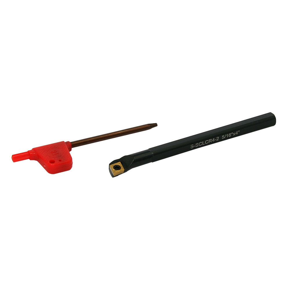

  • Profiling bars for semi-finishing and finishing operations
  • Designed for CCMT 80° inserts
  • 7° Relief angle
  • Negative 5° Lead angle for boring
  • 3° Side & end cutting edge angle
This 5/16" diameter indexable boring bar uses CCMT inserts.
The boring bar is 4" long.
The minimum boring diameter is 0.437".
Use CCMT 21.51 or CCMT 21.52 inserts with this boring bar.
This boring bar does not come with an insert. You must purchase inserts separately.
Overall Length: 4" (101.600 mm)
Diameter: .3125" (7.938 mm)
Minimum Bore: .437" (11.100 mm)
CCMT Inserts: 80°
Replacement Inserts: CCMT-21.51 or CCMT-21.52
Relief Angle: 7°
Lead Angle for Boring: -5°
Side & End Cutting Edge Angle: 3°
Screw: M2.5x8
Torx Wrench: T-8
