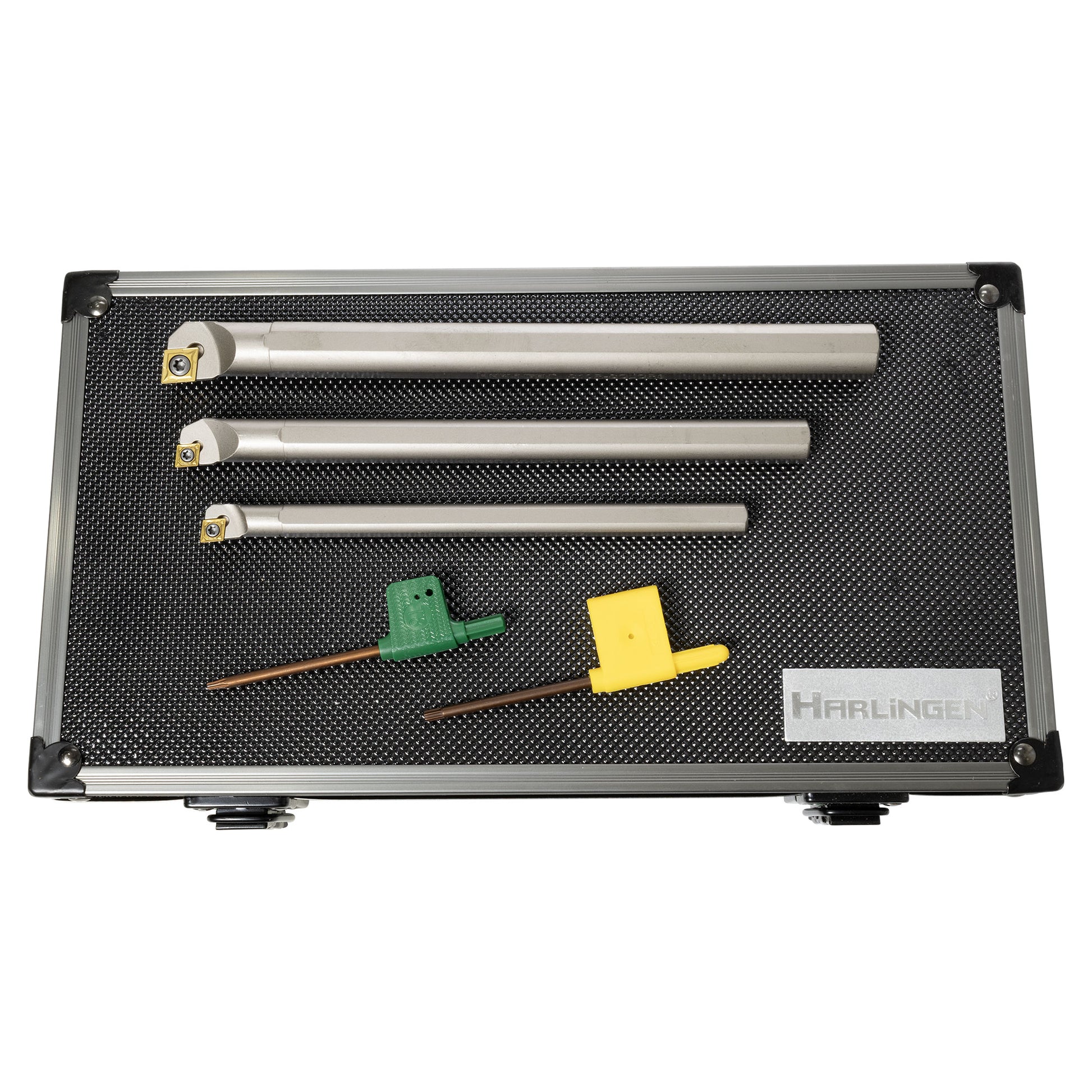

  • 3 piece set, 3/8", 1/2", and 5/8 diameter shanks
  • Carbon steel shanks with 95 degree inserts
  • For boring and facing hole bottoms
  • Suitable for steel, cast iron, and stainless steel

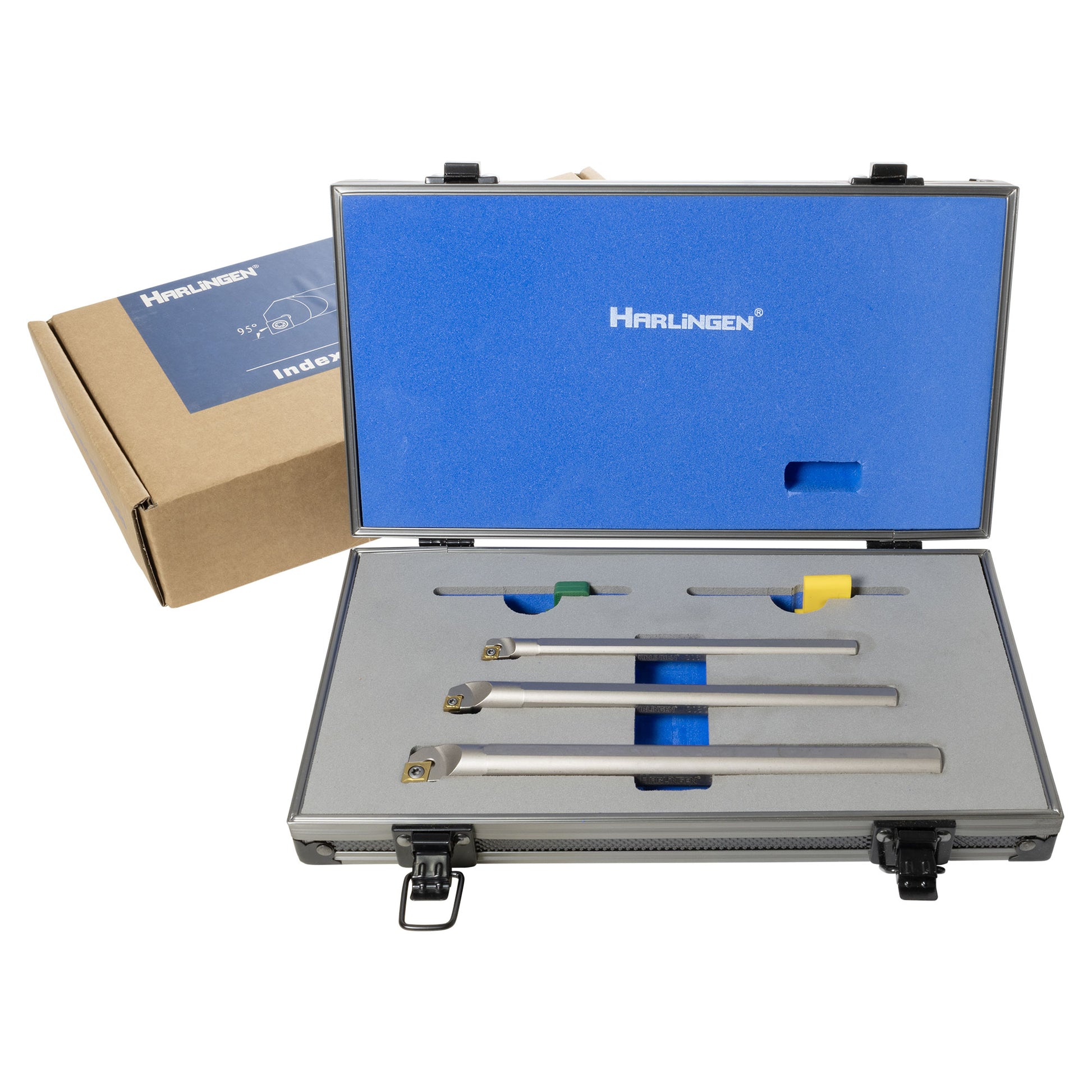

  • Set comes in fitted aluminum case

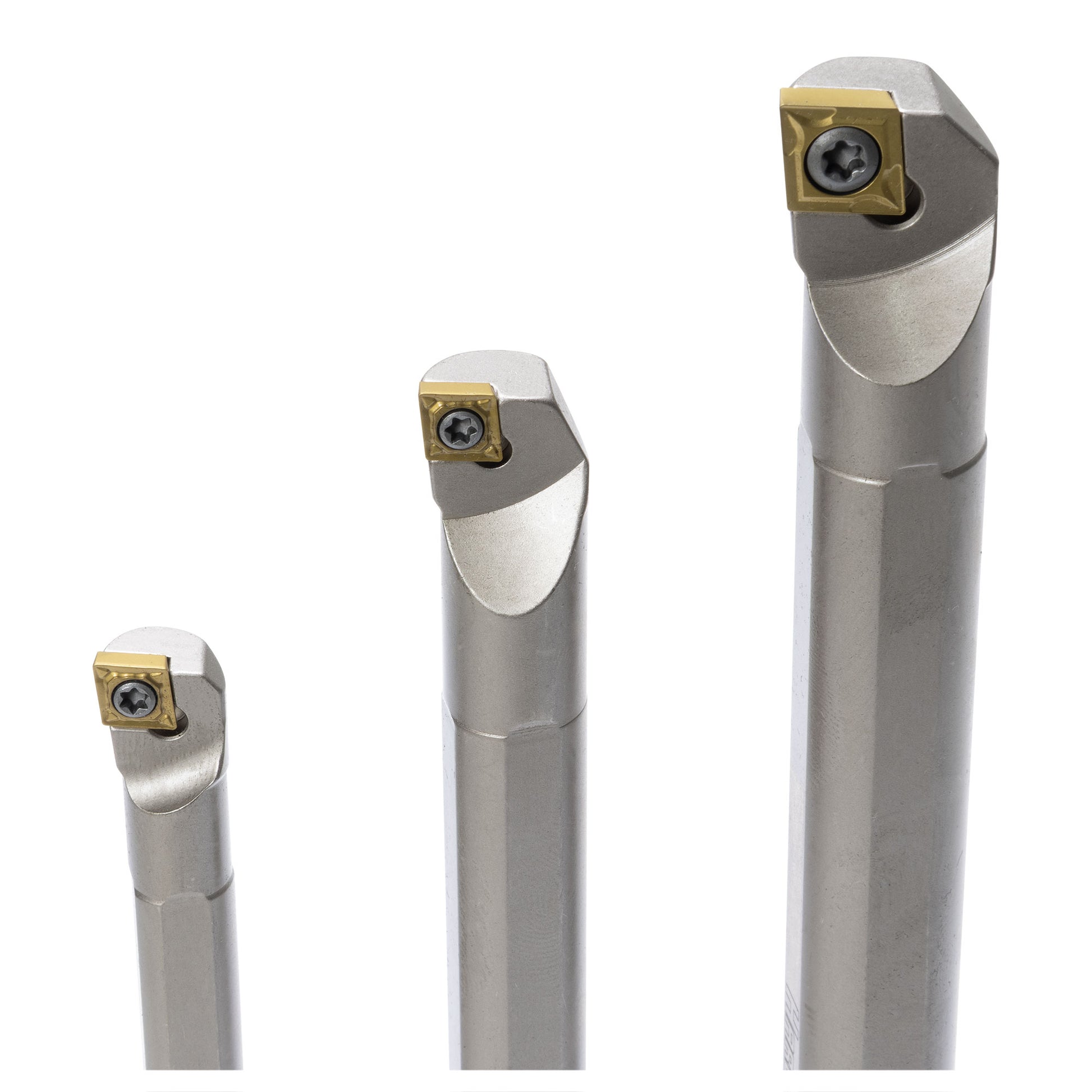

Three piece boring bar set with shank sizes of 3/8", 1/2", and 5/8". Each boring bar has a carbide insert.
This set allows for both boring and facing the bottom of holes. It is suitable for cutting steel, cast iron and stainless steel.
The insert screw is hardened to ensure a solid fit of the carbide insert.

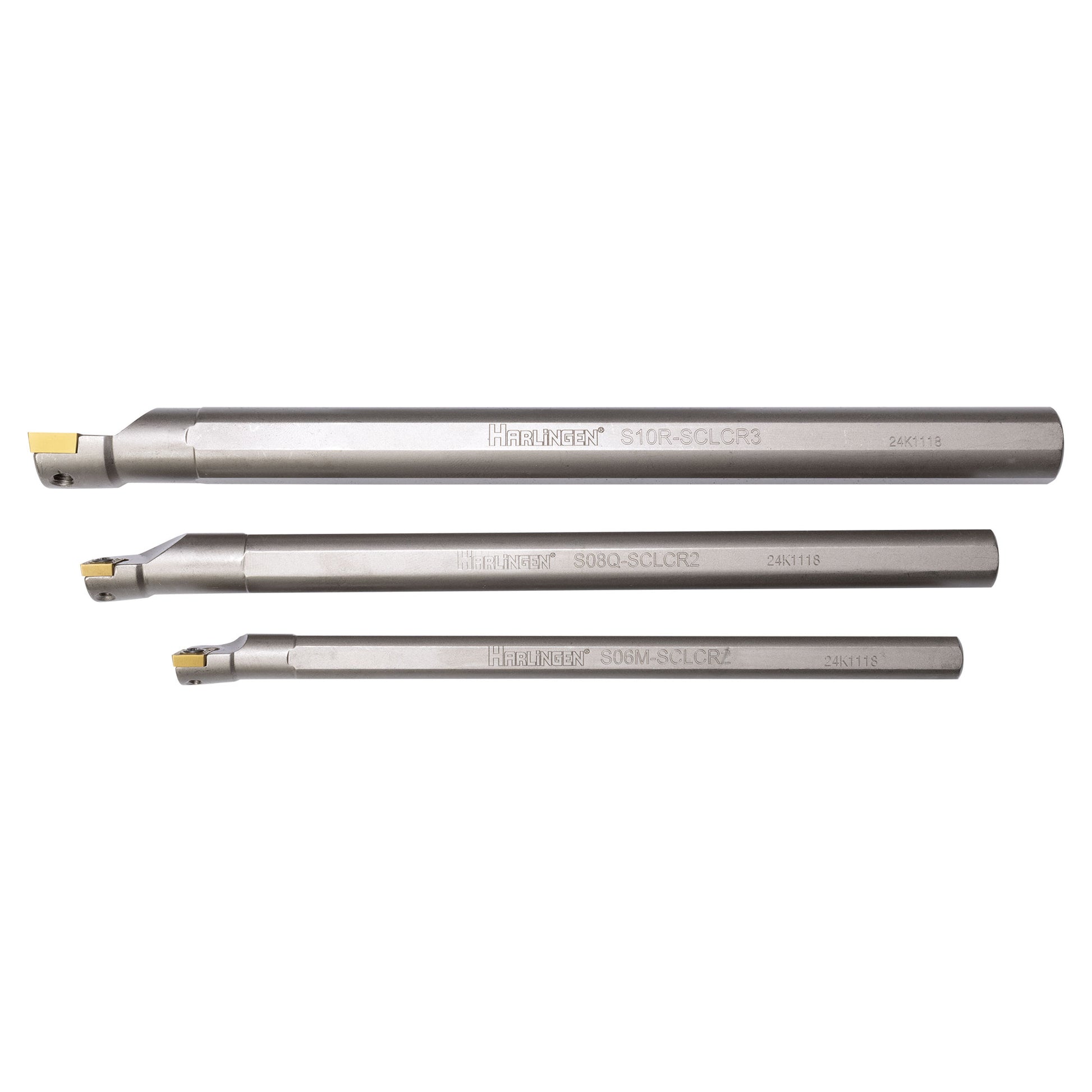

The 3/8" diameter bar is 6" long, designation S06M-SCLCR2 (CCMT 21.5x inserts)
The 1/2" diameter bar is 7" long, designation S08Q-SCLCR2 (CCMT 21.5x inserts)
The 5/8" diameter bar is 8" long, designation S10R-SCLCR3 (CCMT 32.5x inserts)
All three boring bars are designated as having an approach angle of 95 degrees (offset shank with a negative 5 degree cutting angle) and utilizing an insert with a 7 degree relief angle. All three bars are Right Hand.
Set is packed in an aluminum case.
