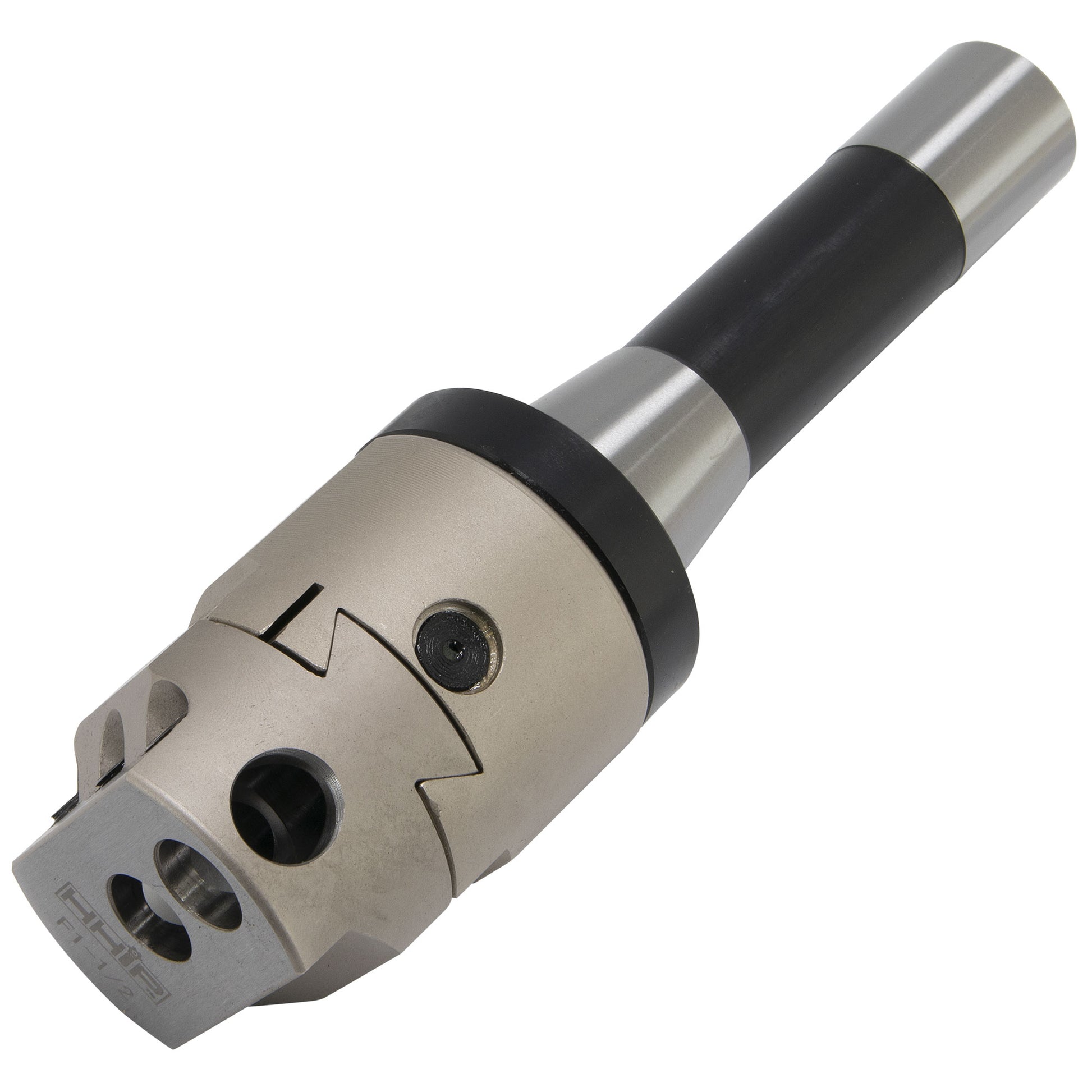

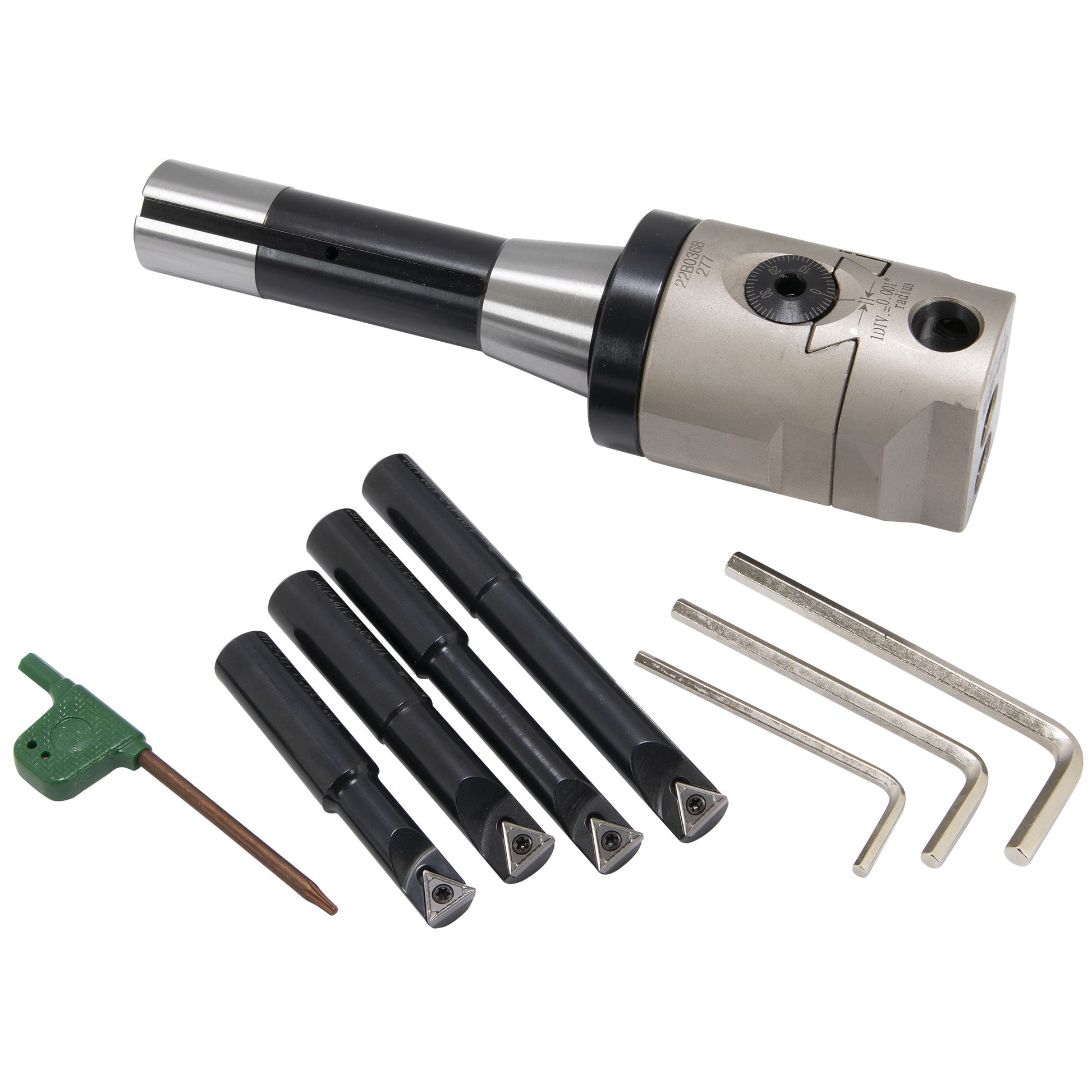

  • Includes boring head, R8 shank, and 4-piece indexable boring bar set
  • The boring head offsets up to 5/8", dial is graduated in 0.001"
  • Minimum bore diameter is 7/16"; Maximum boring diameter is 5.906"
  • Maximum boring depth is 2.5"
  • The included indexable boring bars come with TCMT 21.5 C6 carbide inserts for steel and alloy

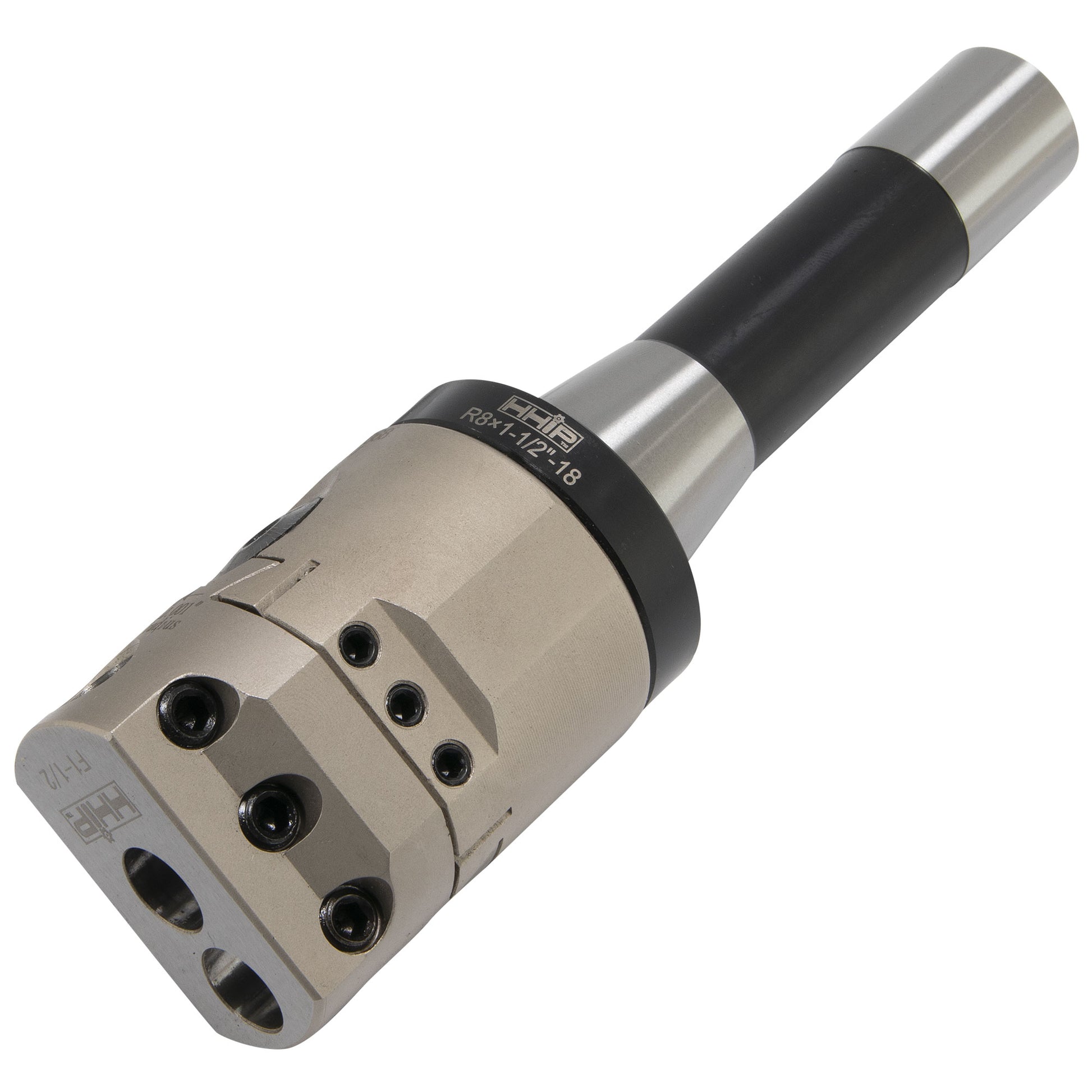

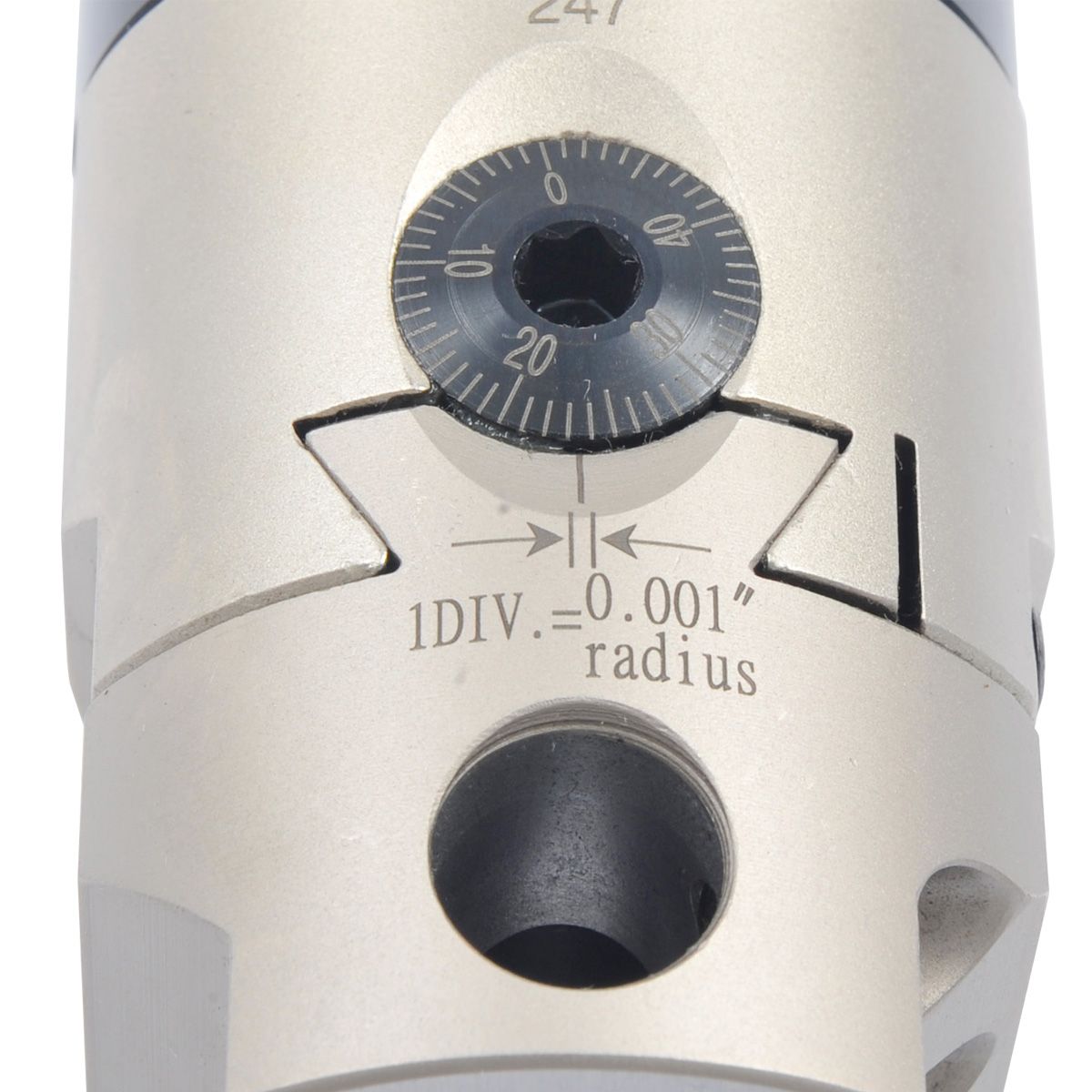

Boring head features a 1-1/2"-18 threaded back so you can change shanks as needed. A micrometer lead screw provides 0.001" direct reading accuracy and makes adjusting easy. 1 DIV = 0.001 which means when turning the dial by 1 division/graduation, the boring head's travel is 0.001" in radius movement and 0.002" in diameter movement. The heat treated, alloy steel shanks are held to 0.000 to -0.0005" from the nominal diameter.
  • Boring head offset is 5/8".
  • Minimum boring diameter is 0.394".
  • Maximum boring diameter is 5.906".
  • Maximum boring depth is 1.970".
  • R8 shank has a drawbar end thread of 7/16"-20.
  • The cross hole is 1/2".

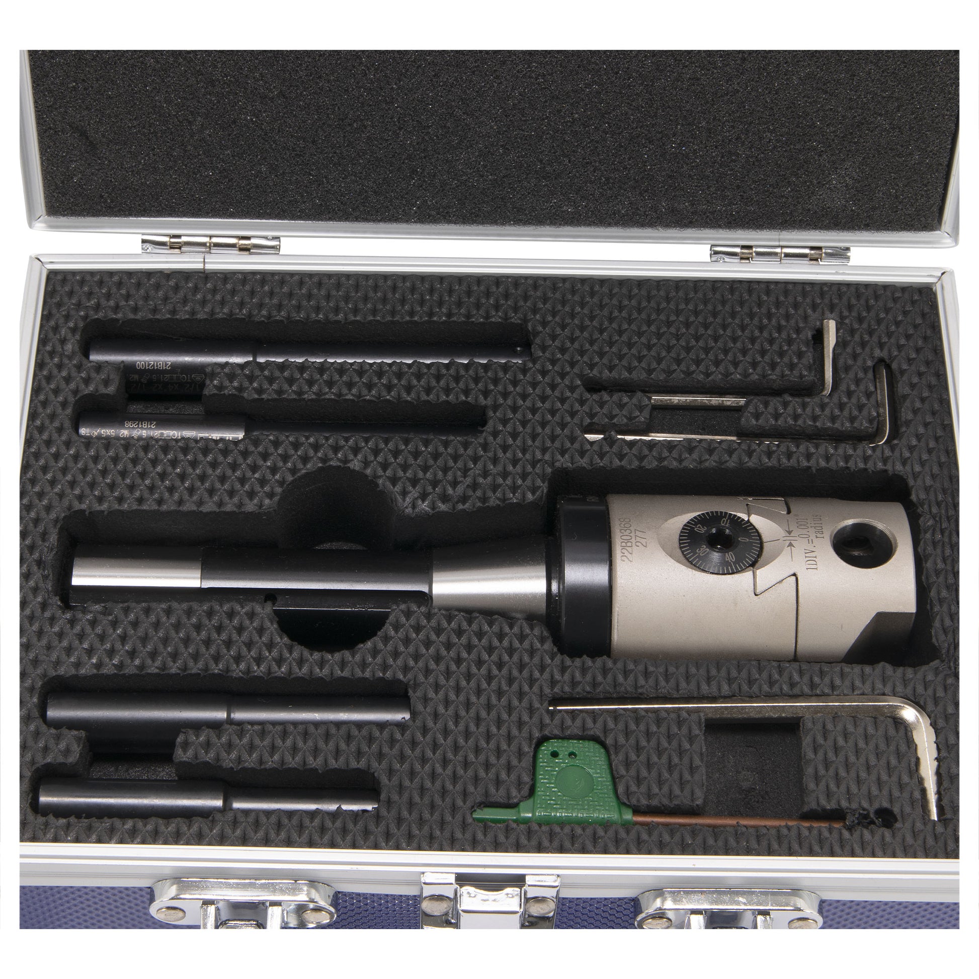

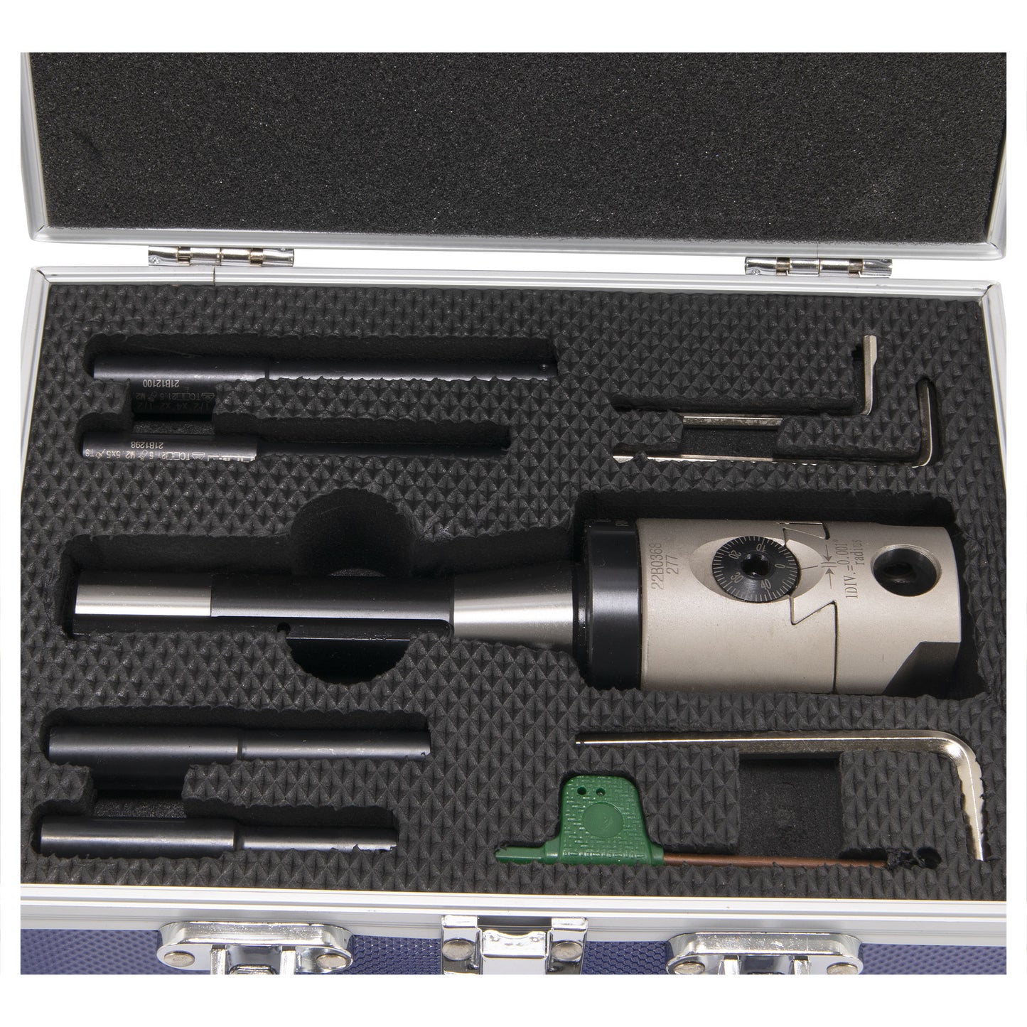

The included indexable boring bars come with TCMT 21.5 C6 carbide inserts for steel and alloy. The set also comes with torx & l-shape hex wrenches and a fitted carrying case.
