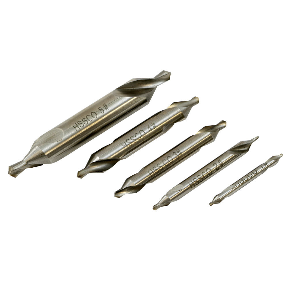

  • Combined drill and countersink
  • Sizes 1, 2, 3, 4 & 5
  • M42 (8% cobalt) high speed steel
  • 60° included angle
  • Right hand cutting direction
This set includes five different sizes of combined drills and countersinks, commonly called center drills. They are used to produce a center hole on a workpiece for turning between centers.
Center drills are also used to start drilled holes. Because they are very stiff they don't have a tendency to wander.
The set is high speed steel and includes sizes 1, 2, 3, 4, and 5. These are 60 degree center drills with a right hand cutting direction. Each center drill is made of ground high speed M42 cobalt steel for good wear resistance.
Combined drills and countersinks, commonly called center drills, are used to produce a center hole on a workpiece for turning between centers. Center drills are also used to start drilled holes. Because they are very stiff they don't have a tendency to wander.
