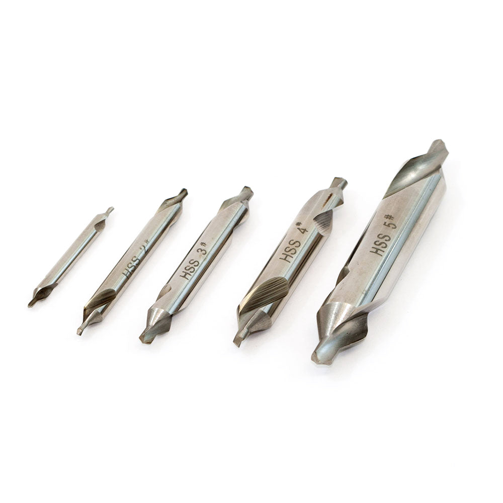

  • Combined drill and countersink
  • Sizes 1, 2, 3, 4 & 5
  • High speed steel
  • 60° included angle
  • Right hand cutting direction
This set includes five different sizes of combined drills and countersinks, commonly called center drills. They are used to produce a center hole on a workpiece for turning between centers.
Center drills are also used to start drilled holes. Because they are very stiff, they don't have a tendency to wander.
The set is high speed steel and includes sizes 1, 2, 3, 4, and 5. These are 60-degree center drills with a right-hand cutting direction. Each center drill countersink is made of ground high speed steel for good wear resistance with a hardness rating of Rc 58 - 60.
Combined drills and countersinks, commonly called center drills, are used to produce a center hole on a workpiece for turning between centers. Center drills are also used to start drilled holes. Because they are very stiff they don't have a tendency to wander.
