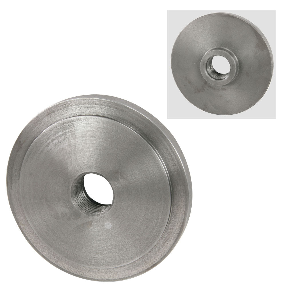

  • Cast iron lathe chuck backplate adapter fits lathes with 1-1/2"-8 spindle nose thread
  • Adapter is 6" (160 mm) in diameter and has no chuck mounting holes
  • Lathe chuck adapter plate can be used for any 6", 5" or 4" lathe chuck
  • Includes instructions for final turning of the registration diameter to ensure concentricity
* These adapters require machining on the lathe on which they will be used. Instructions are included for final turning of the registration diameter on your lathe to ensure perfect concentricity.

These adapters must be machined on your lathe to fit the chuck so that it is concentric on the lathe. In most cases you have to drill the chuck mounting holes also.

Outside Diameter: Ø 6.299",160 mm
Thread: 1.5"-8
Bolt Holes: None
Hub Diameter: Ø 2.205", 56 mm
Hub Length: Ø 0.551", 14 mm
Flange Thickness: Ø 0.630", 16 mm
Registration Boss: Ø 0.157", 4 mm
Registration Diameter: Ø 5.118", 130 mm
