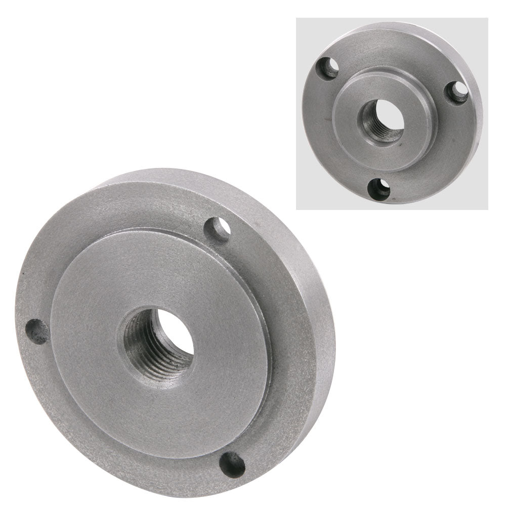

  • Cast iron lathe chuck backplate adapter fits lathes with 1"-10 spindle nose thread
  • Adapter is 4" (100 mm) in diameter and has three chuck mounting holes for a 3-jaw chuck
  • For 4" 3-jaw chucks
  • Includes instructions for final turning of the registration diameter to ensure concentricity
This adapter is for a 4" 3-Jaw chuck such as LittleMachineShop.com PN 1698. NOTE: PN 1791 is the same adapter just without the 3 holes pre-drilled.
* These adapters require machining on the lathe on which they will be used. Instructions are included for final turning of the registration diameter on your lathe to ensure perfect concentricity.

These adapters must be machined on your lathe to fit the chuck so that it is concentric on the lathe. In most cases you have to drill the chuck mounting holes also.

Nominal Size: 4"
Outside Diameter: Ø 3.937",100 mm
Thread: 1"-10
Bolt Holes: 3
Bolt Size: M8
Bolt Circle: Ø 3.307", 84 mm
Hub Diameter: Ø 2.205", 56 mm
Hub Length: Ø 0.394", 10 mm
Flange Thickness: Ø 0.630", 16 mm
Registration Boss: Ø 0.118", 3 mm
Registration Diameter: Ø 2.835", 72 mm
