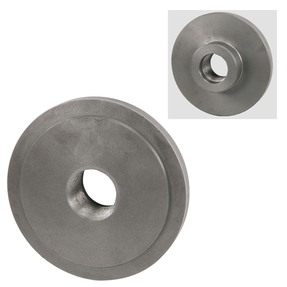

  • Cast iron lathe chuck backplate adapter fits lathes with 1-3/4"-8 spindle nose thread
  • Adapter is 6" (160 mm) in diameter and has no chuck mounting holes
  • Adapter can be used for any 6", 5" or 4" lathe chuck
  • Includes instructions for final turning of the registration diameter to ensure concentricity
This adapter fits the Grizzly G0602 lathe.
* These adapters require machining on the lathe on which they will be used. Instructions are included for final turning of the registration diameter on your lathe to ensure perfect concentricity.

These adapters must be machined on your lathe to fit the chuck so that it is concentric on the lathe. In most cases you have to drill the chuck mounting holes also.
*WOODWORKERS: Our threaded adapters are not suitable for use on wood turning lathes. Please do not purchase them for this application. These adapters require machining on the lathe on which they will be used, and this is impossible on a wood lathe.
