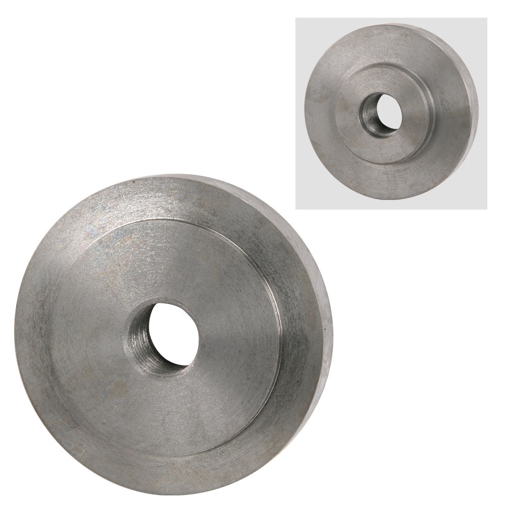

  • Cast iron lathe chuck backplate adapter fits lathes with 1"-10 spindle nose thread
  • Adapter is 4" (100 mm) in diameter and has no chuck mounting holes
  • For all 3" chucks and 4" 4-jaw chucks
  • Includes instructions for final turning of the registration diameter to ensure concentricity
This adapter is for a 4" 3-Jaw chuck such as LittleMachineShop.com PN 1698. See LittleMachineShop.com PN 1917 for a 4" diameter adapter pre-drilled for a 3-jaw chuck.
* These adapters require machining on the lathe on which they will be used. Instructions are included for final turning of the registration diameter on your lathe to ensure perfect concentricity.

Nominal Size: 4"
Outside Diameter: Ø 3.937",100 mm
Thread: 1"-10
Bolt Holes: None
Hub Diameter: Ø 2.205", 56 mm
Hub Length: Ø 0.394", 10 mm
Flange Thickness: Ø 0.630", 16 mm
Registration Boss: Ø 0.118", 3 mm
Registration Diameter: Ø 2.835", 72 mm
