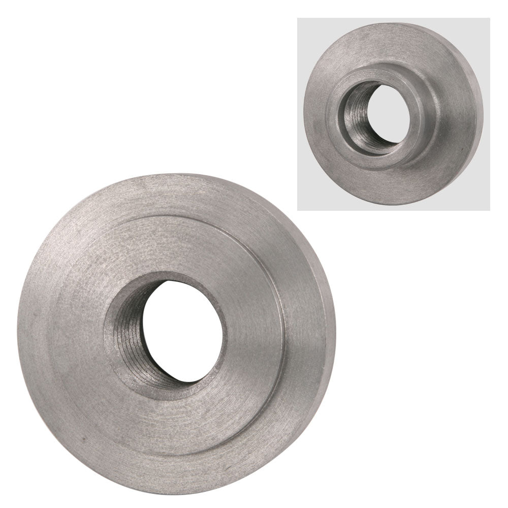

  • Cast iron lathe chuck backplate adapter fits lathes with M39 x 4 spindle nose thread
  • Adapter is 4" (100 mm) in diameter and has no chuck mounting holes
  • For all 3" chucks and 4" chucks
  • Includes instructions for final turning of the registration diameter to ensure concentricity
This chuck adapter fits 9x20 lathes that have a M39x4 spindle nose thread. Use this adapter to mount 4" chucks such as LittleMachineShop.com PN 1698 4" 3-Jaw chuck or PN 1588 4" 4-Jaw chuck. There are no holes in this adapter so you can drill it for either a 3-jaw or 4-jaw chuck.
* These adapters require machining on the lathe on which they will be used. Instructions are included for final turning of the registration diameter on your lathe to ensure perfect concentricity.

Nominal Size: 4"
Outside Diameter: Ø 3.937",100 mm
Thread: M39x4
Bolt Holes: None
Hub Diameter: Ø 2.205", 56 mm
Hub Length: Ø 0.945", 24 mm
Flange Thickness: Ø 0.630", 16 mm
Registration Boss: Ø 0.118", 3 mm
Registration Diameter: Ø 2.835", 72 mm
