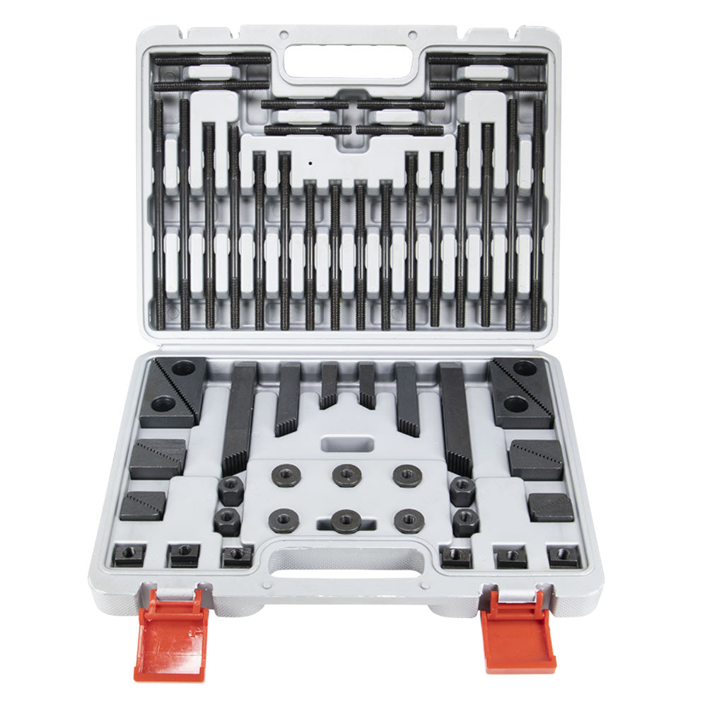

  • Stud thread: 3/8"-16
  • T-slot width at top: 7/16" (12 mm)
  • 58 Pieces
  • All parts are heat treated
  • Organizer case included
58-piece clamping kit 3/8"-16, 7/16" T-Slot in organizer case. This machinist clamping kit fits the 12 mm T-slots on the mini mill. All parts are heat treated. Made of powered casting steel for stronger strength.

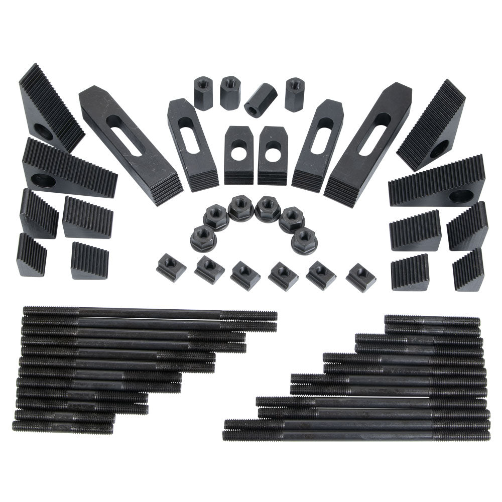

The T-slot clamp kit includes:
  • 24 3/8"-16 studs
  • 12 step blocks in pairs
  • 6 T-slot nuts
  • 6 flange nuts
  • 4 coupling nuts
  • 6 step clamps
Comes in an organizer case.
