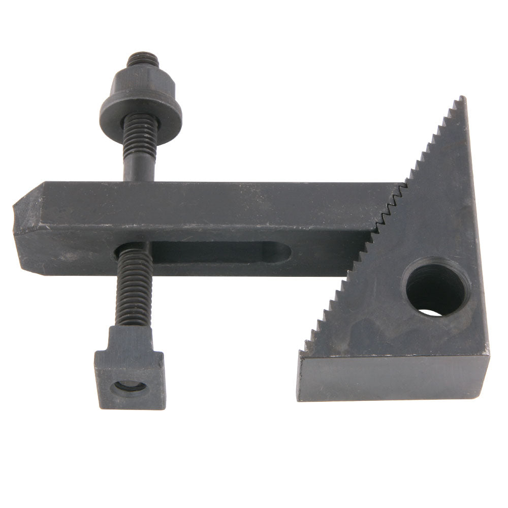

  • Nut fits 7/16" (12 mm) T-Slots
  • Stud thread: 3/8"-16
  • 5 Pieces
  • Made of IC45e steel, hardened to HRC30-40
  • Manufactured at factory for top US brands
Add individual clamping sets to expand your capabilities.
This professional grade clamping kit is manufactured at a world class factory that produces high quality US brands. Pieces are made of IC45e steel for improved strength and all parts are case hardened or heat treated to HRC30-40.

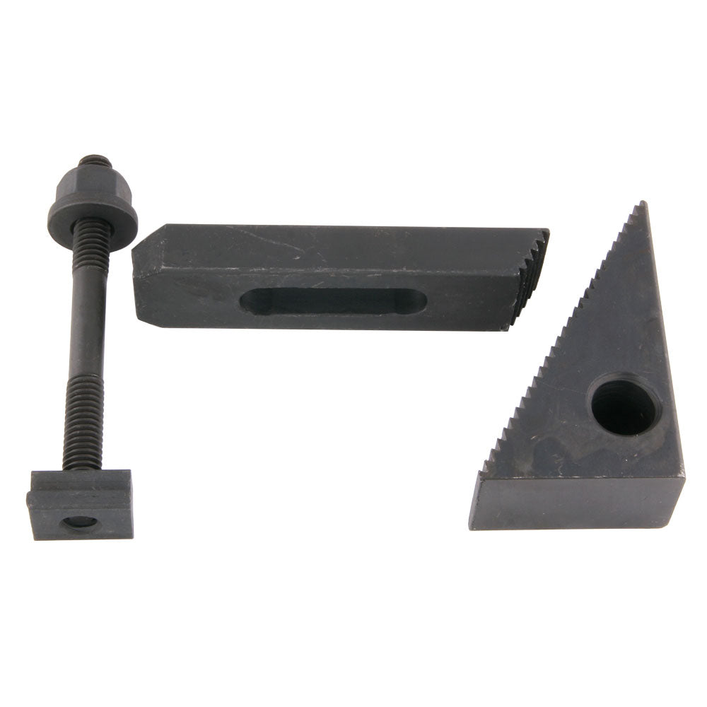

The t-slot clamp kit includes 1 each of:
- 7/16" T-slot nut
- 3/8"-16 stud
- Step clamp
- Step block
- Flange Nut
This machinist clamping kit fits the 12 mm T-slots on the mini mill.

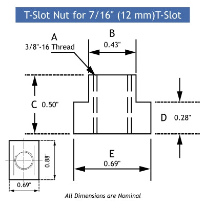

The stated dimension of the clamping kit is the width at the top of the T-slot.
Measure the width at the top of the T-slot on your mill table as shown in the photo below.
This is the dimension given for T-slot nuts and clamping kits. For example, if you measure 0.468 at the top of the T-slot, you should get a 7/16” (0.438”) T-slot nut or clamping kit.
