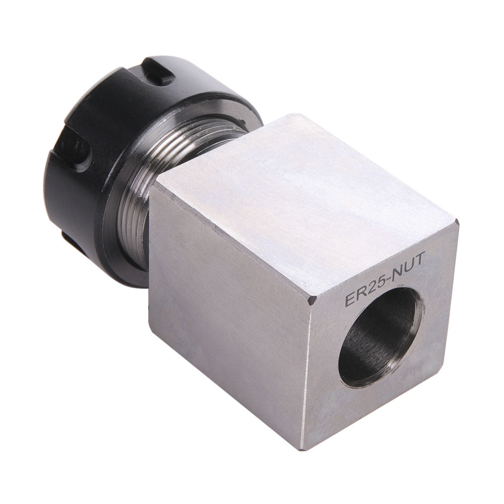

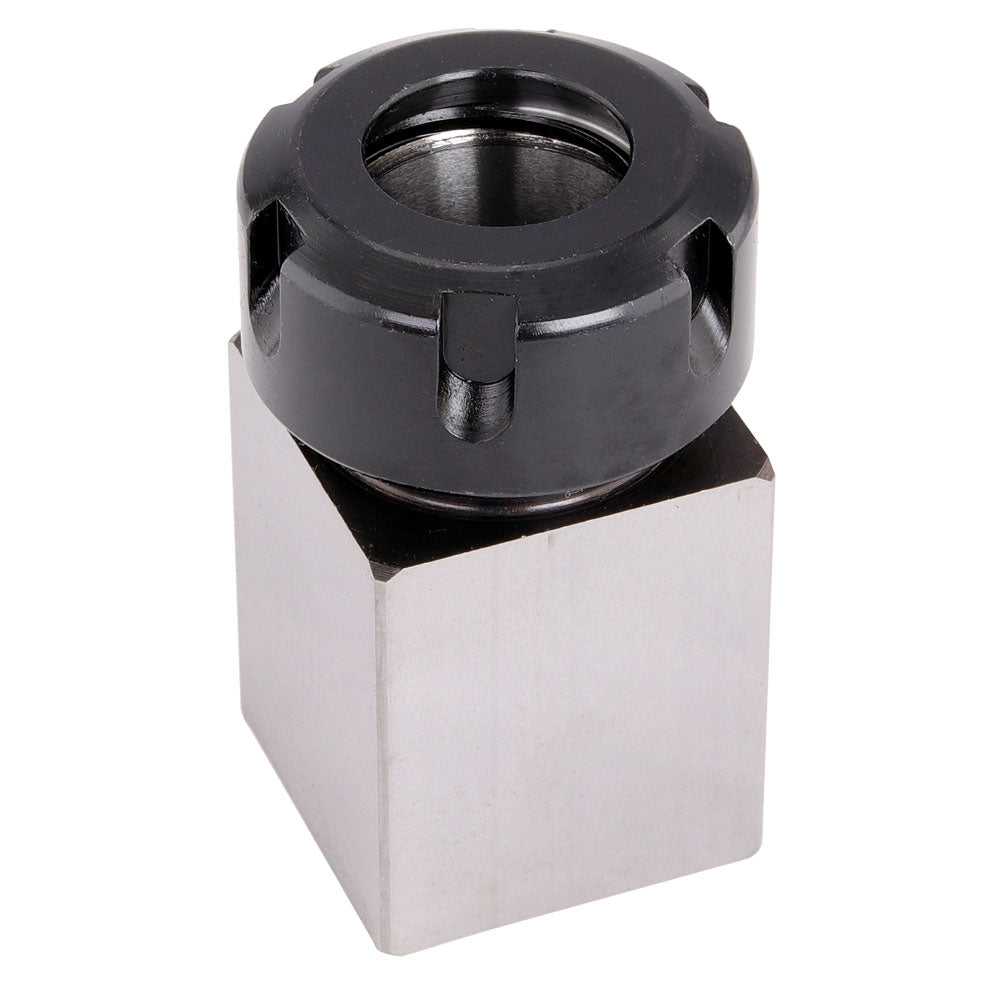

  • Uses standard ER-25 collets
  • Through hole permits long parts to be machined
  • Hardened Tool Steel, Ground to .0005" on all 4 Sides
  • Accurately ground back face so the blocks may be used standing upright
  • Includes ER-25 collet nut
A collet block is a precision workholding device designed to securely grip and position cylindrical or hexagonal workpieces. Unlike traditional vises that clamp with flat jaws, collet blocks utilize a collet – a slotted sleeve with a tapered outer surface – that collapses uniformly around the workpiece when tightened. This provides a concentric and consistent grip, minimizing the risk of distortion or damage, particularly when working with delicate or thin-walled materials.
  • ER-25 collets have a have a clamping range of 1/16" to 5/8" (1.0 mm to 16.0 mm).
  • This collet block provides easy indexing for 2 and 4 divisions.
  • The collet block is 1.48" square and the body is 2.7" long.
The collet block itself is typically a hardened steel block, often square or hexagonal, with a precision-machined bore to accommodate the collet. The combination of the precision collet and the stable block creates a rigid and accurate platform for a wide range of machining operations.
