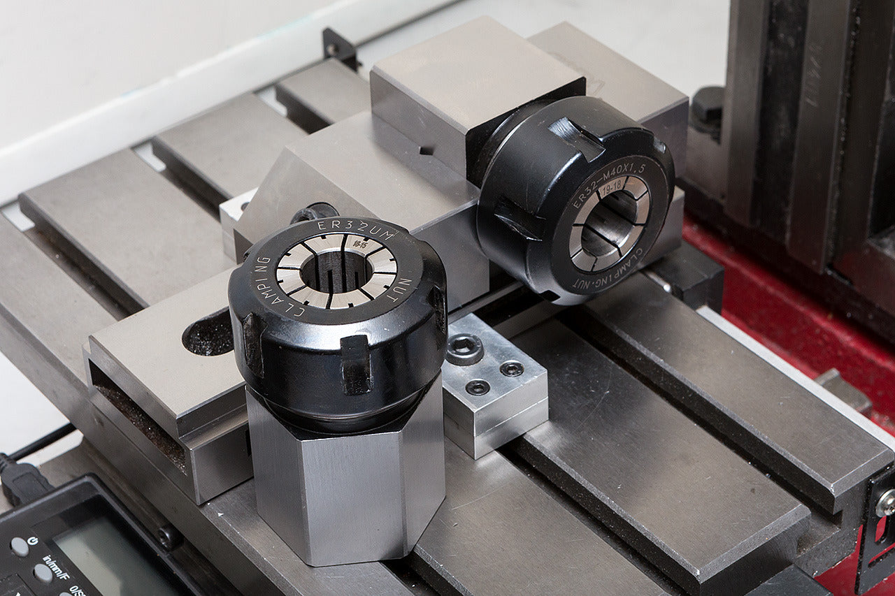

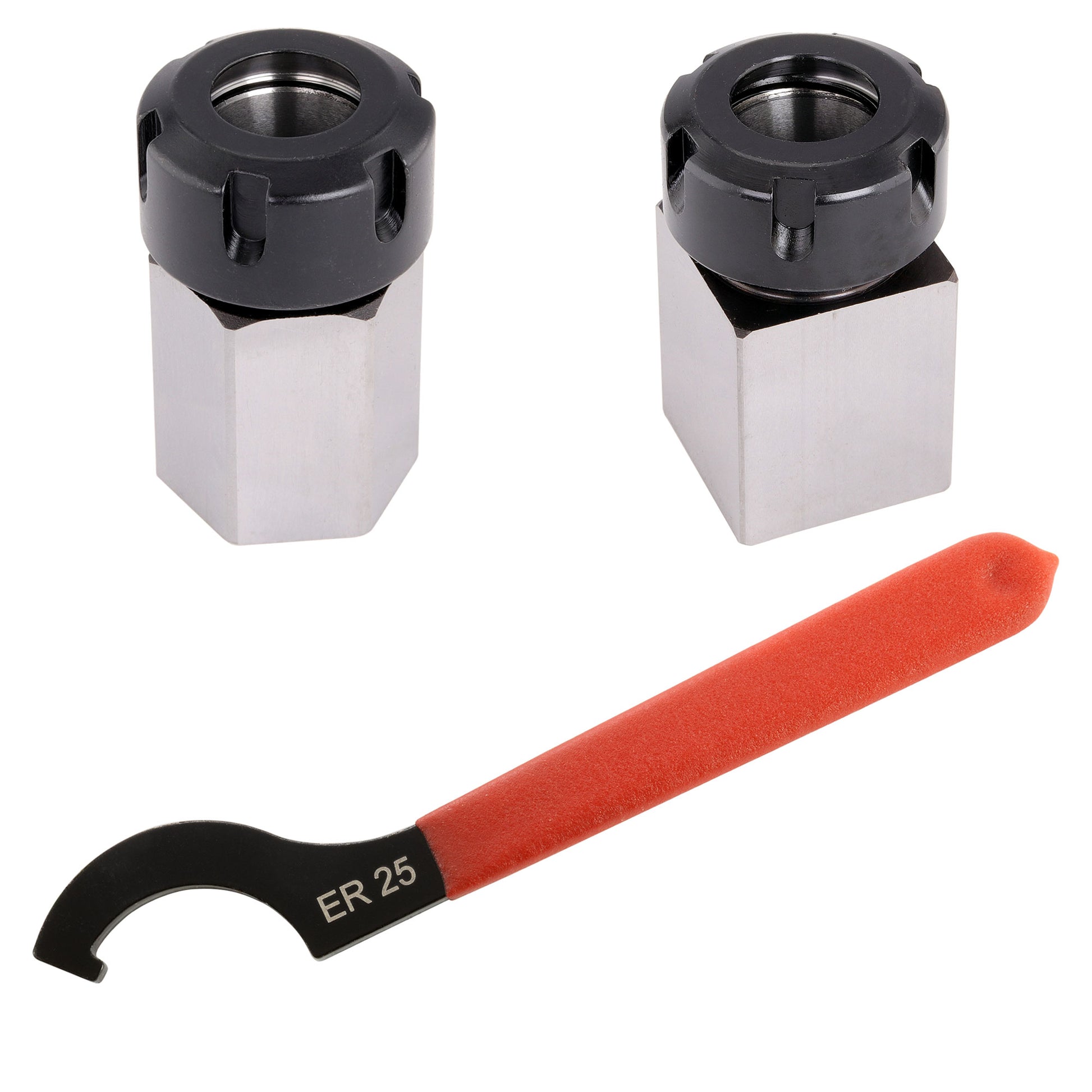

  • Uses standard ER-25collets
  • Through hole permits long parts to be machined
  • Hardened Tool Steel, Ground to .0005" on all 4 Sides
  • Accurately ground back face so the blocks may be used standing upright
  • Includes ER-25 collet nut
  • Wrench for ER-25chuck nuts with slots
A collet block is a precision workholding device designed to securely grip and position cylindrical or hexagonal workpieces. Unlike traditional vises that clamp with flat jaws, collet blocks utilize a collet – a slotted sleeve with a tapered outer surface – that collapses uniformly around the workpiece when tightened. This provides a concentric and consistent grip, minimizing the risk of distortion or damage, particularly when working with delicate or thin-walled materials.
The collet block itself is typically a hardened steel block, often square or hexagonal, with a precision-machined bore to accommodate the collet. The combination of the precision collet and the stable block creates a rigid and accurate platform for a wide range of machining operations.
This SQUARE collet block provides easy indexing for 2 and 4 divisions.
The collet block is 1.48" square and the body is 2.7" long.
This HEXAGONAL collet block provides easy indexing for 3 and 6 divisions.
The collet block is 1.75" across the flats and the body is 2.7" long.
ER-25 collets have a have a clamping range of 1/16" to 5/8" (1.0 mm to 16.0 mm).
This spanner wrench fits ER-25 collet nuts (38-42 mm).
ER Collet Nuts
Collet blocks are commonly used on milling machines to hold round or hexagonal stock for machining flats, slots, or other features. The secure grip and precise positioning enable accurate and repeatable milling operations such as drilling and tapping operations, ensuring that holes are accurately positioned and perpendicular to the workpiece surface.
