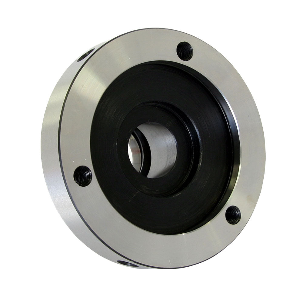

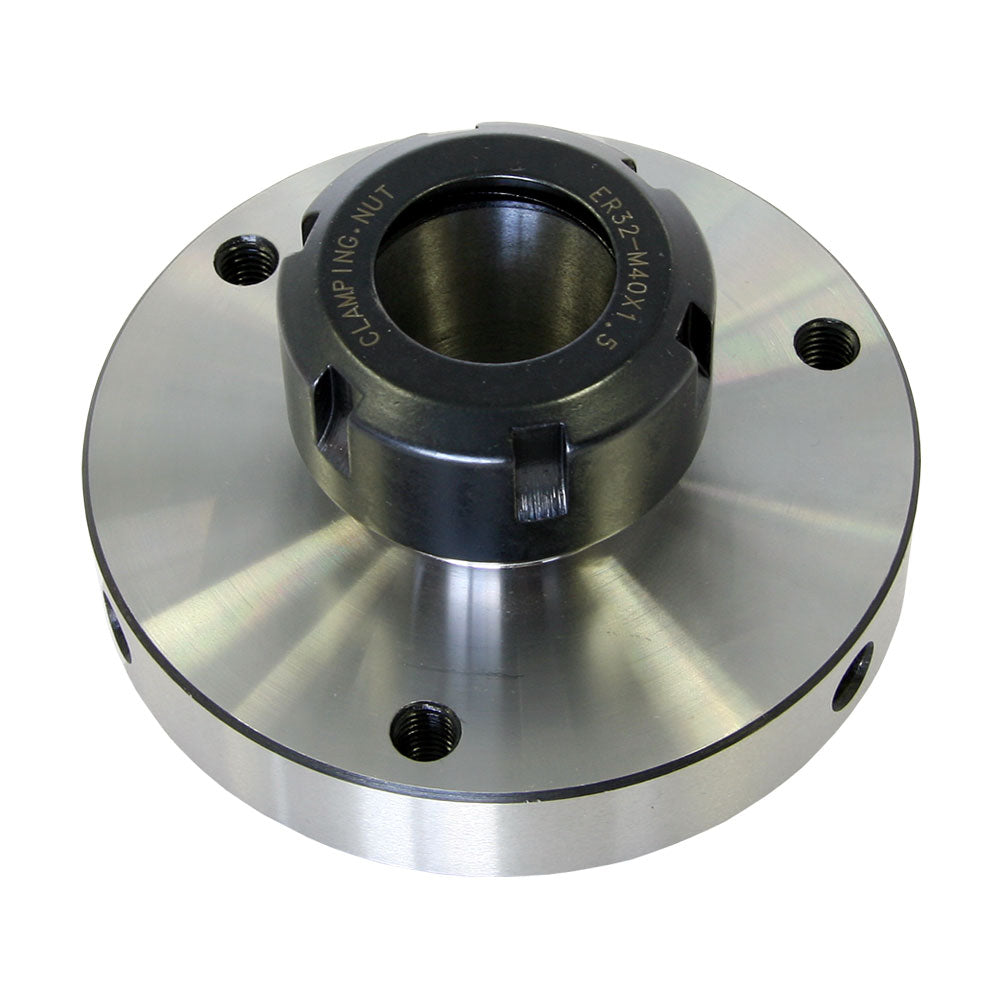

  • ER-32 4" collet chuck
  • Mounts on 4" spindle flange or adapter
  • Shorter than standard 3-jaw chuck
  • Allows 25/32" stock through the headstock of the lathe
  • Concentricity .0008"
This collet chuck for ER-32 collets mounts on the lathe spindle in place of the lathe chuck or can be used as a fixture on a milling table.
ER-32 collets range in size from 3/32" up to 13/16" so you can run 25/32" stock (the through hole on the lathe spindle is 0.800") through the headstock of your lathe.
The outside diameter of the collet chuck is 100 mm. It has a 72 mm registration diameter and mounts with three M8 bolts on a 84 mm bolt circle. The concentricity of this chuck is 0.0008" (0.02 mm).
