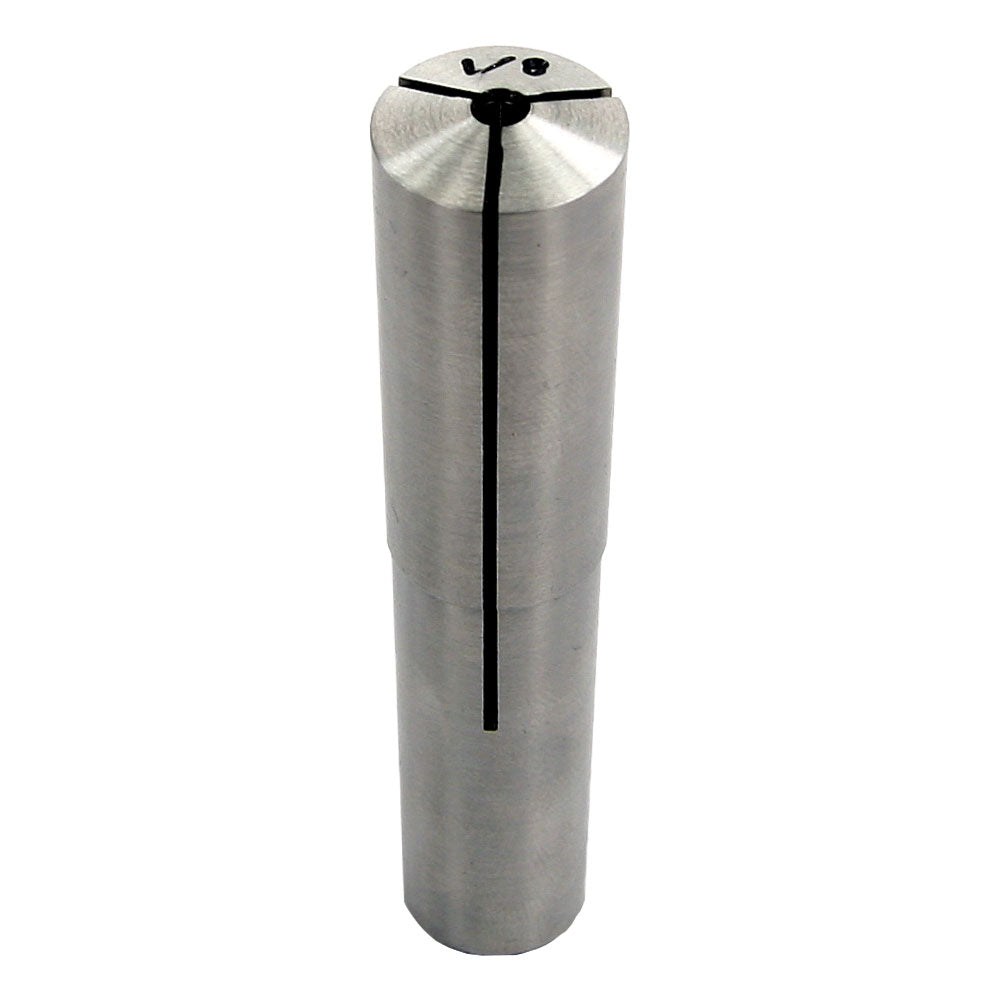

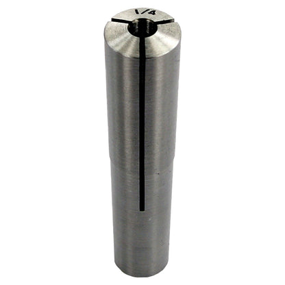

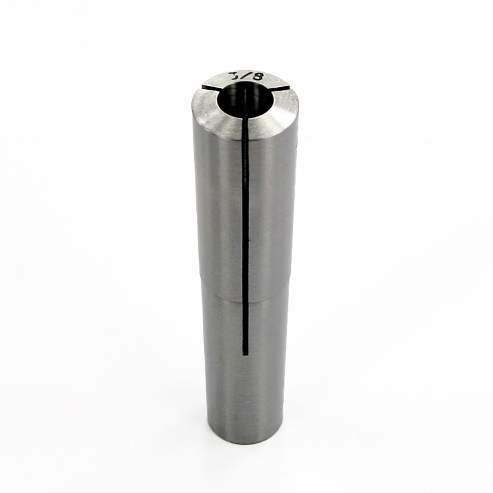

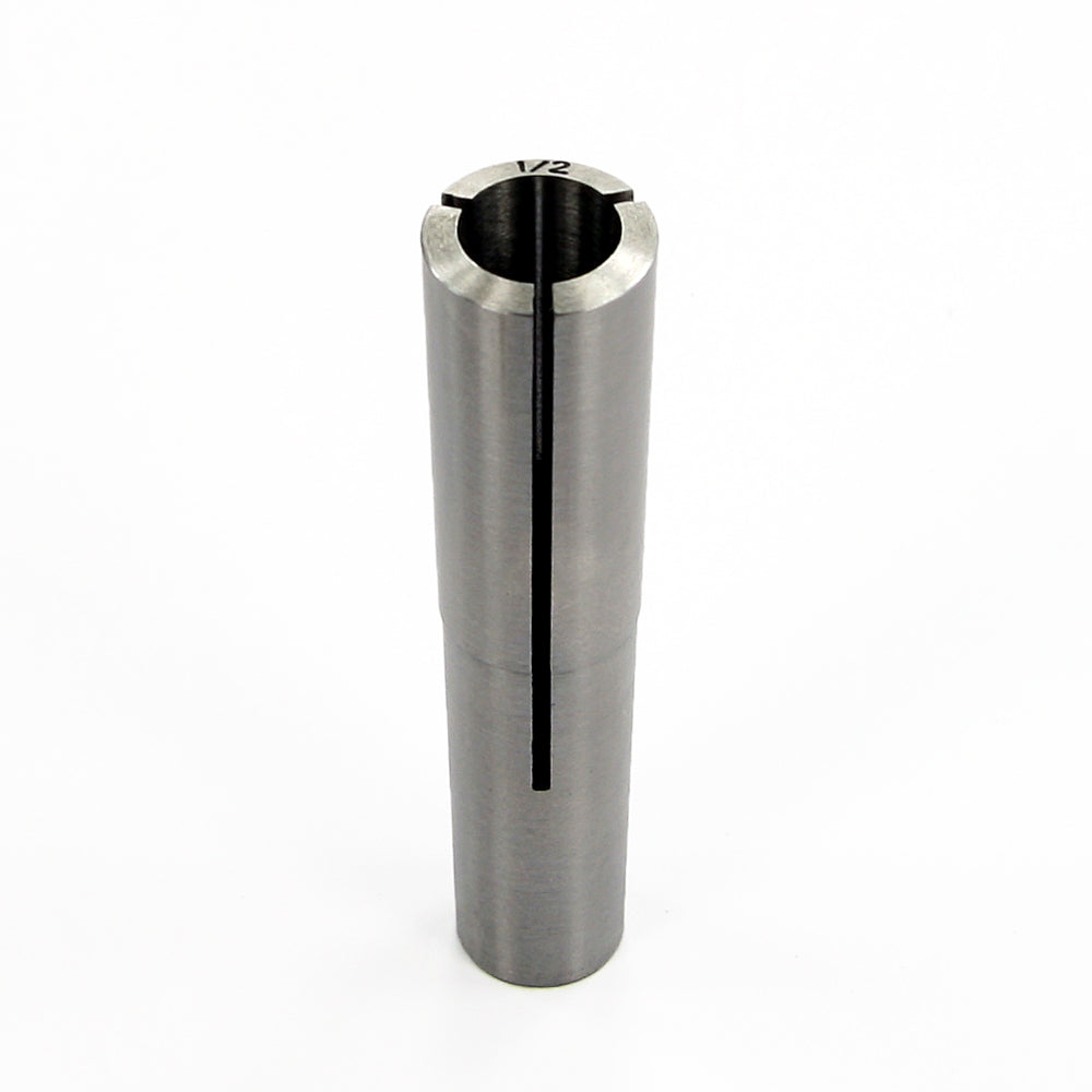

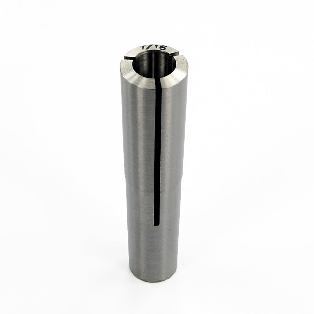

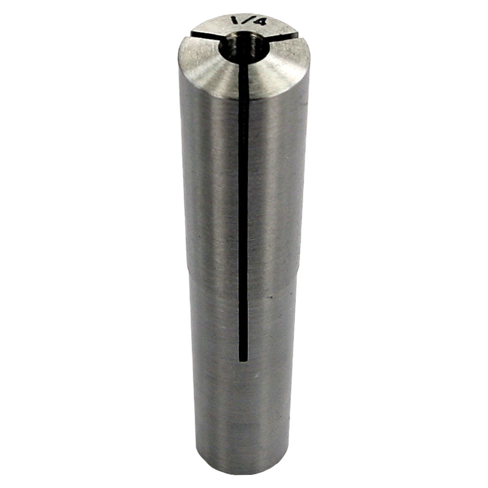

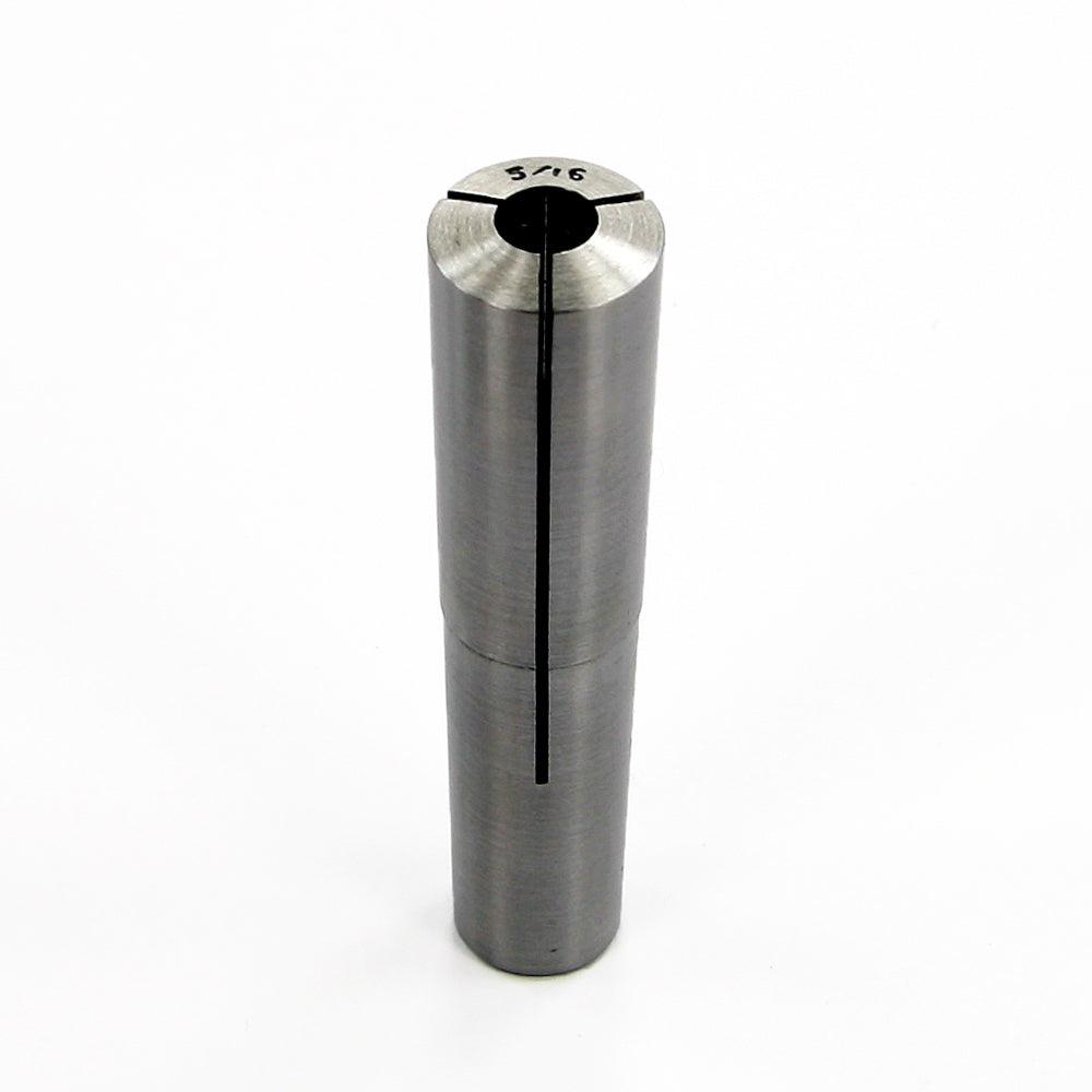

- Brown & Sharpe #7 collets
- Hardened and precision ground
- 3/8"-16 drawbar thread
- 0.0008” (0.02 mm) maximum runout
- Overall length is 3.15"
Brown & Sharpe #7 taper round collets to fit spindles with a Brown & Sharpe taper. Individual sizes ranges from 1/8" to 1/2".
This collet is made from high-grade tool steel and is precision ground and hardened. Maximum runout is 0.0008” (0.02 mm).
Drawbar thread is 3/8"-16, the width at the top is 0.725" and the width at the bottom is 0.600". Overall length is 3.15".
