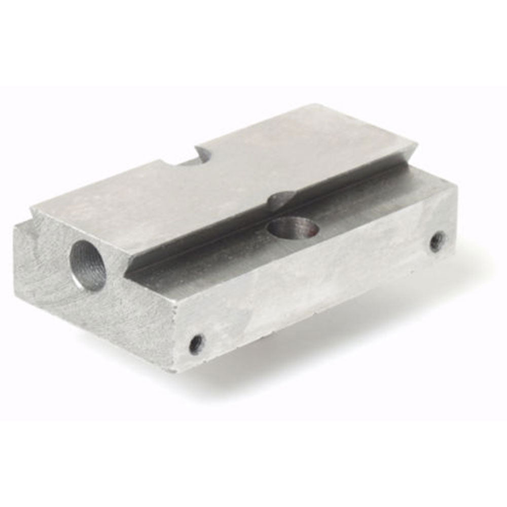

- Pre-drilled compound rest bottom, mini lathe
- For lathes with a 1 mm thread pitch, 0.0394" per revolution
- Use with dial having 40 divisions
- Fits numerous SIEG C2 and C3 and HiTorque mini lathes
This is the bottom half of the compound rest on the SIEG C2 and C3 and HiTorque mini lathes
The thread pitch is 1 mm so the compound advances 0.040" (actually 0.0394") per revolution. Use with a dial that has 40 divisions.
J. W. Early suggests that you machine 0.25" off the bottom of this part. He also suggests that you move the tool post pivot point. This allows you to use several different adjustable tool posts more effectively.
For a compound with the pivot point already moved, see our modified compound rest bottom.
