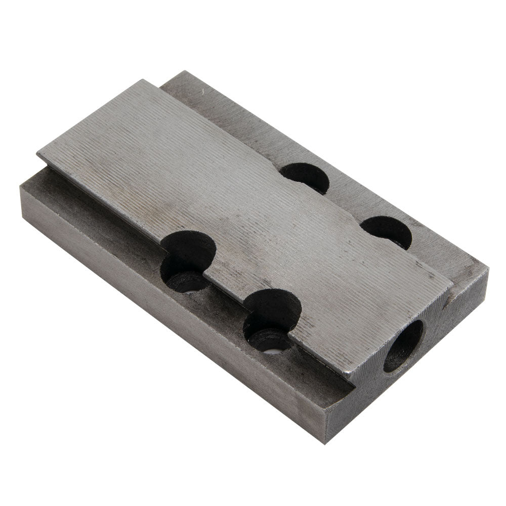

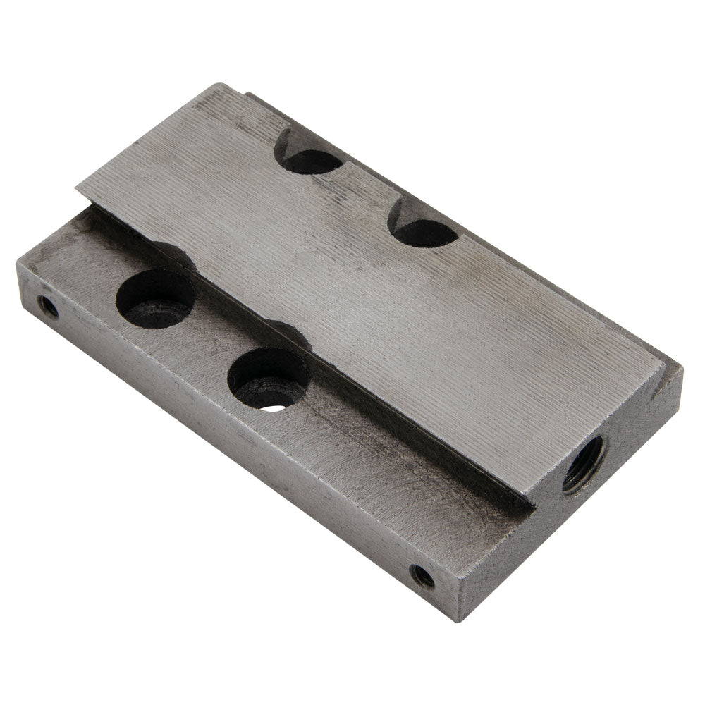

  • Pre-drilled & milled compound rest bottom, mini lathe
  • Extra holes to eliminate chatter
  • 1/4" thinner that standard part allows AXA tool posts
  • For lathes with a 1 mm thread pitch, 0.0394" per revolution
  • Fits numerous SIEG C2 and C3 and HiTorque mini lathes
This is the bottom half of the compound rest on the mini lathe.
This part has a second set of holes that moves the center of rotation of the compound rest to help eliminate chatter.
This part is also about 1/4" thinner than the standard part. This makes it possible to mount AXA or Series 100 tool posts on the mini lathe.
Use the holes nearest the end of the part. Do not expect to use this without a quick change tool post of some sort. It will place the standard tool post about 1/4" too low.
The thread pitch is 1 mm so the compound advances 0.040" (actually 0.0394") per revolution. Use with a dial that has 40 divisions.
We offer two compound rest bottoms modified to J. W. Early's design.
Parts 1677 and 1880 have a second set of holes that move the pivot of the compound rest which helps to cut down on chatter.
Parts 1777 and 1881 has the second set of holes, but is also about 1/4" thinner than the standard part.
